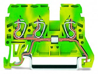

3-проводная клеммная колодка заземления; 2,5 мм²; боковые маркерные пазы; для DIN-рейки 35 x 15 и 35 x 7,5; CAGE CLAMP

| Actuation type | Operating tool |
| Цвет | green-yellow |
| Connectable conductor materials | Copper |
| Connection technology | CAGE CLAMP® |
| Country of origin | DE |
| Габариты: глубина | 49 mm / 1.929 inch |
| Design | horizontal |
| Fine-stranded conductor | 0.08 … 4 mm² / 28 … 12 AWG |
| Fire load | 0.093 MJ |
| GTIN | 4045454094607 |
| Height from upper-edge of DIN-35 rail | 27.5 mm / 1.083 inch |
| Insulating material | Polyamide 66 (PA 66) |
| Marking level | Side marking |
| Number of levels | 1 |
| Solid conductor | 0.08 … 2.5 mm² / 28 … 12 AWG |
| Strip length | 6 … 7 mm / 0.24 … 0.28 Inch |
| Total number of connection points | 3 |
| Total number of potentials | 1 |
| Type of mounting | DIN-35 rail |
| Type of wiring | Front-entry wiring |
| Вес | 7.297 г |
| Ширина | 5 mm / 0.197 inch |
