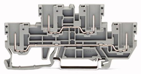

2-проводные / 2-контактные двухуровневые базовые клеммы; Проходные / проходные клеммы; L/L; для DIN-рейки 35 x 15 и 35 x 7,5; 2,5 мм²; CAGE CLAMP

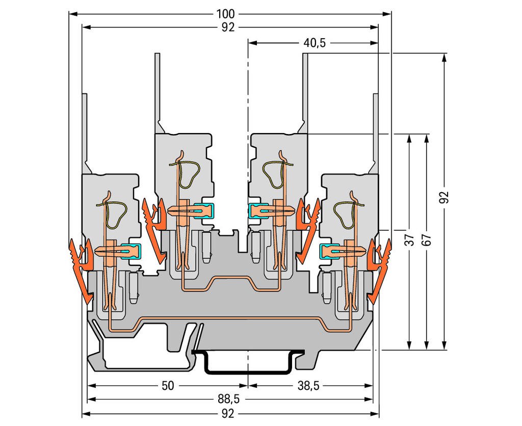

Actuation type | Operating tool |
Цвет | gray |
Connectable conductor materials | Copper |
Country of origin | DE |

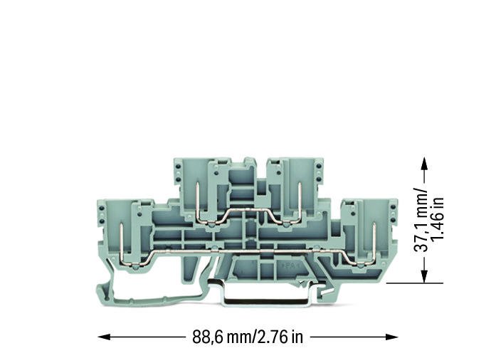

Габариты: глубина | 88.6 mm / 3.488 inch |
Design | horizontal |
Fire load | 0.185 MJ |
GTIN | 4045454397265 |
Height from upper-edge of DIN-35 rail | 37.1 mm / 1.461 inch |
Legend (ratings) | (III / 3) ≙ Overvoltage category III / Pollution degree 3 |
Marking level | Side marking |
Number of levels | 2 |
Potential marking | L/L |
Product Group | 16 (Rail Mounted Terminal Block with CCC) |
Rated current | 16 A |
Rated impulse voltage (III / 3) | 6 kV |
Rated voltage (III / 3) | 500 В |
Total number of potentials | 2 |
Type of mounting | DIN-35 rail |
Type of wiring | Front-entry wiring |
Вес | 10.3 г |
Ширина | 5 mm / 0.197 inch |
