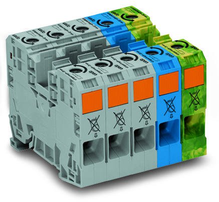

Datasheet Wago 285-139 — Даташит
Трехфазный комплект; с сильноточными клеммами 35 мм²; только для рейки DIN 35 x 15; медь; 35 мм²; POWER CAGE CLAMP
Купить 285-139 на РадиоЛоцман.Цены — от 10 970 до 13 477 ₽12 предложений от 5 поставщиков THREE PHASE SET; WITH 35 MM HIGH | |||
| 285-139 Wago | от 10 970 ₽ | ||
| 285-139 | от 11 297 ₽ | ||
| 285-139 Wago | 13 477 ₽ | ||
| 285-139 Wago | по запросу | ||
| Actuation type | Operating tool |
| Цвет | gray, blue, green-yellow |
| Connectable conductor materials | Copper |
| Connection technology | POWER CAGE CLAMP |
| Country of origin | DE |
| Габариты: глубина | 86 mm / 3.386 inch |
| Design | horizontal |
| Fine-stranded conductor | 6 … 35 mm² / 10 … 2 AWG |
| Fire load | 6.233 MJ |
| GTIN | 4045454584252 |
| Height from upper-edge of DIN-35 rail | 63 mm / 2.48 inch |
| Insulating material | Polyamide 66 (PA 66) |
| Marking level | Side marking |
| Number of levels | 1 |
| Product Group | 1 (Rail Mounted Terminal Blocks) |
| Rated impulse voltage (III / 3) | 8 kV |
| Rated voltage (III / 3) | 1000 В |
| Solid conductor | 6 … 35 mm² / 10 … 2 AWG |
| Strip length | 25 mm / 0.98 Inch |
| Total number of connection points | 10 |
| Total number of potentials | 5 |
| Type of mounting | DIN-35 rail |
| Type of wiring | Side-entry wiring |
| Вес | 425.675 г |
