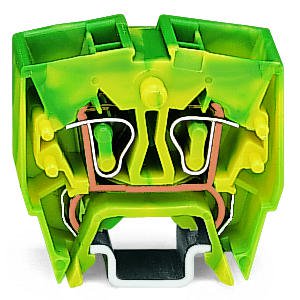

4-проводная мини-клеммная колодка для монтажа на рейку; 2,5 мм²; подходит для применений Ex e II; маркировка центра; для рейки DIN-15; CAGE CLAMP
4-CONDUCTOR MINI RAIL-MOUNT TERM | |||
| 264-727/999-950 Wago | по запросу | ||
| Actuation type | Operating tool |
| Цвет | green-yellow |
| Connectable conductor materials | Copper |
| Connection technology | CAGE CLAMP® |
| Country of origin | DE |
| Габариты: глубина | 32 mm / 1.26 inch |
| Design | horizontal |
| Fine-stranded conductor | 0.08 … 2.5 mm² / 28 … 12 AWG |
| Fire load | 0.108 MJ |
| GTIN | 4044918462457 |
| Height from upper-edge of DIN-35 rail | 24.5 mm / 0.965 inch |
| Marking level | Center marking |
| Number of levels | 1 |
| Product Group | 9 (Std. Chassis Mt. Blocks) |
| Solid conductor | 0.5 … 2.5 mm² / 20 … 12 AWG |
| Strip length | 8 … 9 mm / 0.31 … 0.35 Inch |
| Total number of connection points | 4 |
| Total number of potentials | 1 |
| Type of mounting | DIN-15 rail |
| Type of wiring | Front-entry wiring |
| Вес | 8.08 г |
| Ширина | 10 mm / 0.394 inch |
