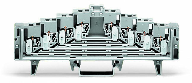

Actuation type | Operating tool |
Цвет | gray |
Connectable conductor materials | Copper |
Connection technology | CAGE CLAMP® |
Country of origin | DE |
Габариты: глубина | 126 mm / 4.961 inch |
Design | horizontal |
Fine-stranded conductor | 0.08 … 1.5 mm² / 28 … 16 AWG |
Fire load | 0.55 MJ |
GTIN | 4045454188580 |
Height from upper-edge of DIN-35 rail | 44.5 mm / 1.752 inch |
Legend (ratings) | (III / 3) ≙ Overvoltage category III / Pollution degree 3 |
Marking | a-b-c-d--d-c-b-a |
Marking level | Center marking |
Number of levels | 4 |
Rated current | 12 A |
Rated impulse voltage (III / 3) | 4 kV |
Rated voltage (III / 3) | 250 В |
Solid conductor | 0.08 … 1.5 mm² / 28 … 16 AWG |
Strip length | 8 … 10 mm / 0.31 … 0.39 Inch |
Total number of connection points | 16 |
Total number of potentials | 4 |
Type of mounting | DIN-35 rail |
Type of wiring | Front-entry wiring |
Вес | 32 г |
Ширина | 7.62 mm / 0.3 inch |
