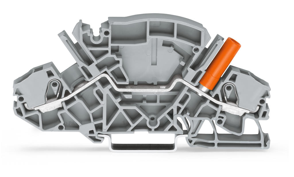

2-проводная проходная клеммная колодка; 6 мм²; с защищенным от прикосновений тестовым гнездом; для тестовых штекеров Ø 4 мм; боковая и центральная маркировка; для DIN-рейки 35 x 15 и 35 x 7,5; зажим Push-in CAGE CLAMP

Actuation type | Open Tool Slot |
Цвет | gray |
Connectable conductor materials | Copper |
Connection technology | Push-in CAGE CLAMP® |
Country of origin | CN |
Габариты: глубина | 99.6 mm / 3.921 inch |
Design | angled |
Fine-stranded conductor | 0.5 … 10 mm² / 20 … 8 AWG |
Fine-stranded conductor with ferrule without plastic collar | 1.5 … 6 mm² / 16 … 10 AWG |
Fine-stranded conductor with ferrule, push-in termination, from | 1.5 mm² / 16 AWG |
Fire load | 0.387 MJ |
GTIN | 4055143074742 |
Height from upper-edge of DIN-35 rail | 46.8 mm / 1.843 inch |
Legend (ratings) | (III / 3) ≙ Overvoltage category III / Pollution degree 3 |
Marking level | Center/side marking |
Nominal cross section | 6 mm² |
Number of levels | 1 |
Product Group | 22 (TOPJOB S) |
Rated current | 30 A |
Rated impulse voltage (III / 3) | 6 kV |
Rated voltage (III / 3) | 500 В |
Solid conductor | 0.5 … 10 mm² / 20 … 8 AWG |
Solid conductor, push-in termination | 1 … 10 mm² / 14 … 8 AWG |
Strip length | 13 … 15 mm / 0.51 … 0.59 Inch |
Total number of connection points | 2 |
Total number of potentials | 1 |
Type of mounting | DIN-35 rail |
Type of wiring | Front-entry wiring |
Вес | 22.243 г |
Ширина | 8 mm / 0.315 inch |
