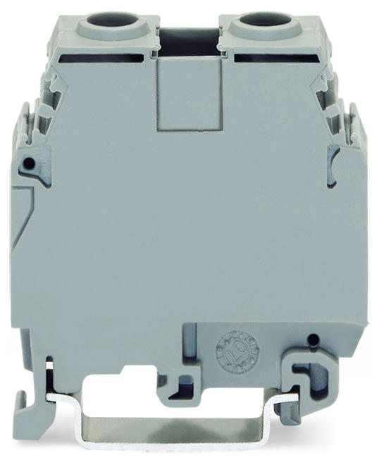

Datasheet Wago 400-415/415-124 — Даташит
Клеммная колодка винтового типа; 35 мм²; для DIN-рейки 35 x 15 и 35 x 7,5
400-415/415-124 Wago | по запросу |
Actuation type | Operating tool |
Цвет | gray |
Connectable conductor materials | Copper |
Connection technology | Screw-clamp connection/Studs |
Country of origin | DE |
Габариты: глубина | 49 mm / 1.929 inch |
Design | horizontal |
GTIN | 4055143765282 |
Height from upper-edge of DIN-35 rail | 46.5 mm / 1.831 inch |
Legend (ratings) | (III / 3) ≙ Overvoltage category III / Pollution degree 3 |
Marking level | Side marking |
Number of levels | 1 |
Rated current | 125 A |
Rated impulse voltage (III / 3) | 8 kV |
Rated voltage (III / 3) | 1000 В |
Solid conductor | 6 … 35 mm² / 10 … 2 AWG |
Strip length | 17 … 19 mm / 0.67 … 0.75 Inch |
Total number of connection points | 2 |
Total number of potentials | 1 |
Type of mounting | DIN-35 rail |
Type of wiring | Side-entry wiring |
Вес | 32.89 г |
Ширина | 16 mm / 0.63 inch |
