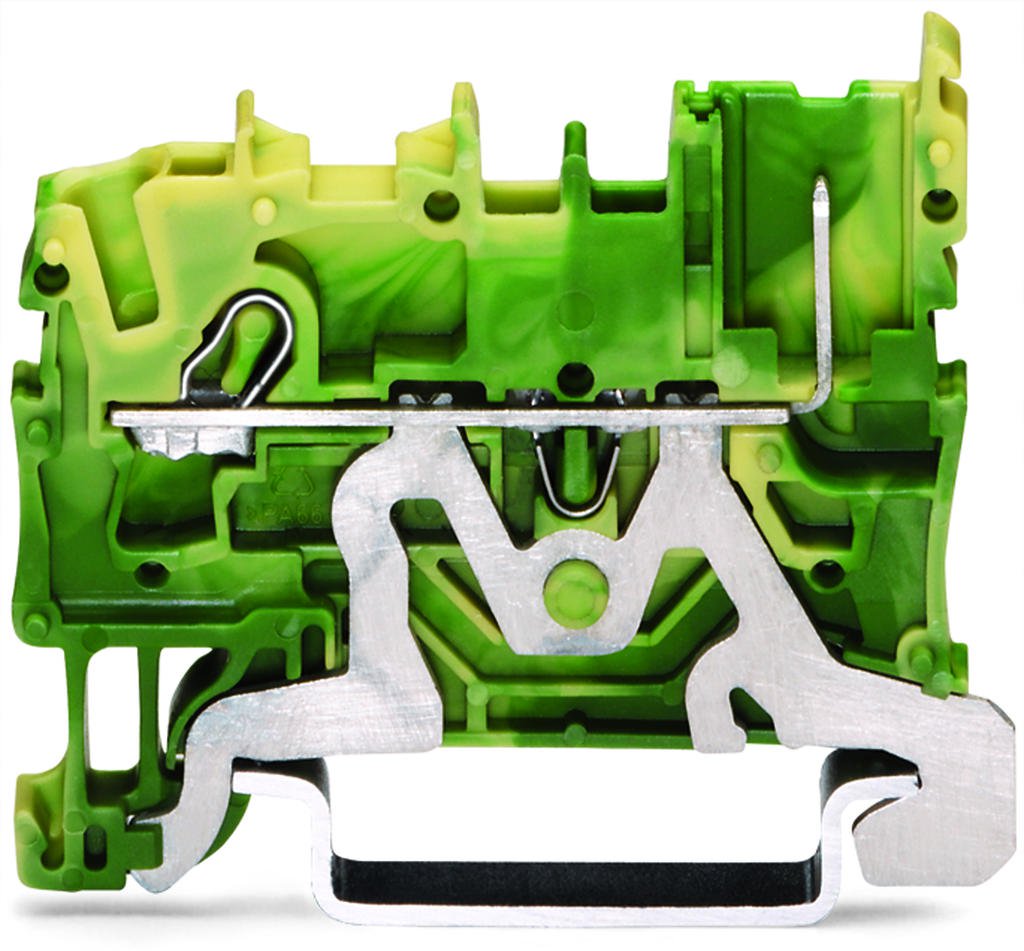

Datasheet Wago 2022-1207 — Даташит
1-проводная/1-контактная клеммная колодка с заземлением; для DIN-рейки 35 x 15 и 35 x 7,5; 2,5 мм²; Push-in CAGE CLAMP
Купить 2022-1207 на РадиоЛоцман.Цены — от 326 до 621 ₽14 предложений от 11 поставщиков Клеммные Блоки, 12Position Single Row Dual Barrier 9.52mm Pitch 12-22AWG Barrier Terminal Block | |||
| 2022-1207 Wago | от 621 ₽ | ||
| A20221207 Cooper Bussmann | по запросу | ||
| A202212-07 Vishay | по запросу | ||
| 2022-1207/999-953 Wago | по запросу | ||
| Actuation type | Operating tool Push-in |
| Цвет | green-yellow |
| Connectable conductor materials | Copper |
| Connection technology | Push-in CAGE CLAMP® |
| Country of origin | CN |
| Габариты: глубина | 50.8 mm / 0.2 inch |
| Design | horizontal |
| Fine-stranded conductor | 0.25 … 4 mm² / 22 … 12 AWG |
| Fine-stranded conductor with ferrule, push-in termination, from | 0.75 mm² / 18 AWG |
| Fire load | 0.108 MJ |
| GTIN | 4050821145097 |
| Height from upper-edge of DIN-35 rail | 32.5 mm / 1.28 inch |
| Insulating material | Polyamide 66 (PA 66) |
| Legend (ratings) | (III / 3) ≙ Overvoltage category III / Pollution degree 3 |
| Marking level | Center/side marking |
| Nominal cross section | 2.5 mm² |
| Number of levels | 1 |
| Product Group | 18 (X-COM-System) |
| Solid conductor | 0.25 … 4 mm² / 22 … 12 AWG |
| Solid conductor, push-in termination | 0.75 … 4 mm² / 18 … 12 AWG |
| Strip length | 10 … 12 mm / 0.39 … 0.47 Inch |
| Total number of connection points | 1 |
| Total number of potentials | 1 |
| Type of mounting | DIN-35 rail |
| Type of wiring | Front-entry wiring |
| Вес | 7.837 г |
| Ширина | 5.2 mm / 0.205 inch |
