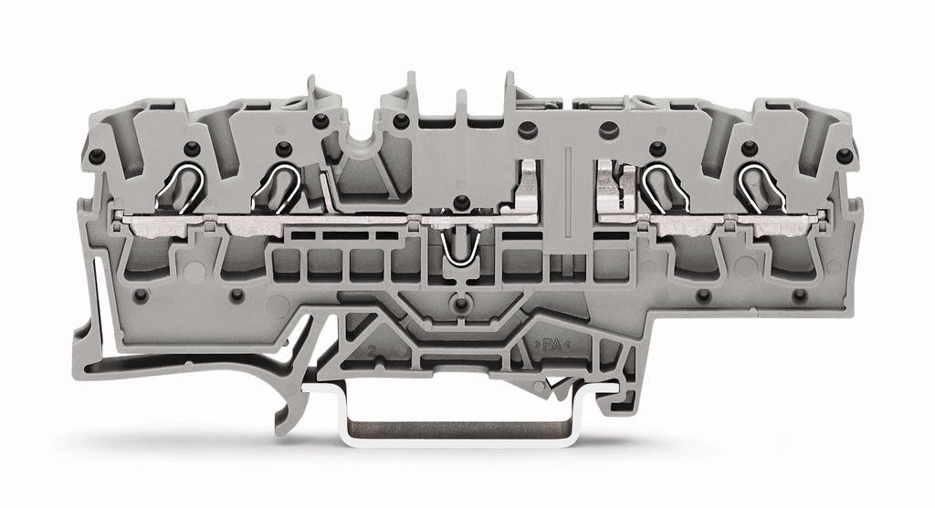

| Actuation type | Open Tool Slot |
| Цвет | gray |
| Connectable conductor materials | Copper |
| Connection technology | Push-in CAGE CLAMP® |
| Country of origin | CN |
| Габариты: глубина | 87.5 mm / 3.445 inch |
| Design | horizontal |
| Fine-stranded conductor | 0.25 … 4 mm² / 22 … 12 AWG |
| Fine-stranded conductor with ferrule, push-in termination, from | 0.75 mm² / 18 AWG |
| Fire load | 0.191 MJ |
| GTIN | 4045454974886 |
| Height from upper-edge of DIN-35 rail | 32.9 mm / 1.295 inch |
| Insulating material | Polyamide 66 (PA 66) |
| Legend (ratings) | (III / 3) ≙ Overvoltage category III / Pollution degree 3 |
| Marking level | Center/side marking |
| Nominal cross section | 2.5 mm² |
| Number of levels | 1 |
| Product Group | 22 (TOPJOB S) |
| Rated current | 10 A |
| Rated impulse voltage (III / 3) | 6 kV |
| Rated voltage (III / 3) | 400 В |
| Solid conductor | 0.25 … 4 mm² / 22 … 12 AWG |
| Solid conductor, push-in termination | 0.75 … 4 mm² / 18 … 12 AWG |
| Strip length | 10 … 12 mm / 0.39 … 0.47 Inch |
| Total number of connection points | 4 |
| Total number of potentials | 2 |
| Type of mounting | DIN-35 rail |
| Type of wiring | Front-entry wiring |
| Вес | 9.303 г |
| Ширина | 5.2 mm / 0.205 inch |
