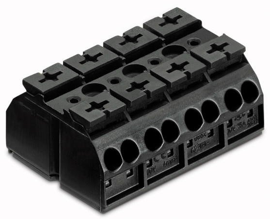

Datasheet Wago 862-594 — Даташит
4-проводная клеммная колодка для монтажа на шасси; защелкивающаяся ножка в поз.

1+4; гладкая; без заземляющего контакта; 4-полюсная
Actuation type | Operating tool Push-button |
Цвет | black |
Connectable conductor materials | Copper |
Connection technology | Push-in CAGE CLAMP® |
Country of origin | DE |
Габариты: глубина | 35 mm / 1.378 inch |
Fine-stranded conductor | 0.5 … 4 mm² / 20 … 12 AWG |
Fine-stranded conductor with ferrule with plastic collar | 0.5 … 2.5 mm² / 20 … 12 AWG |
Fine-stranded conductor with ferrule, push-in termination, from | 0.75 mm² / 18 AWG |
Fire load | 0.505 MJ |
GTIN | 4044918509282 |
Height from the surface | 22.3 mm / 0.878 inch |
Legend (ratings) | (III / 3) ≙ Overvoltage category III / Pollution degree 3 |
Marking | plain |
Mounting type | Snap-in mounting foot |
Number of Poles | 4 |
Packaging type | bag |
Pin spacing | 12 mm / 0.472 inch |
Rated current | 32 A |
Rated impulse voltage (III / 3) | 6 kV |
Rated voltage (III / 3) | 500 В |
Solid conductor | 0.5 … 4 mm² / 20 … 12 AWG |
Solid conductor, push-in termination | 0.75 … 4 mm² / 18 … 12 AWG |
Stranded conductor | 0.5 … 4 mm² / 20 … 12 AWG |
Strip length | 10 … 11 mm / 0.39 … 0.43 Inch |
Total number of connection points | 16 |
Total number of potentials | 4 |
Type of wiring | Side-entry wiring |
Вес | 27.37 г |
Ширина | 48 mm / 1.89 inch |
