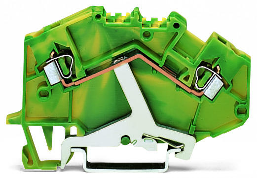

2-проводная клеммная колодка заземления; 2,5 мм²; маркировка центра; для DIN-рейки 35 x 15 и 35 x 7,5; CAGE CLAMP

Actuation typeOperating tool
Цветgreen-yellow
Connectable conductor materialsCopper
Connection technologyCAGE CLAMP®
Country of originDE
Габариты: глубина77 mm / 3.031 inch
Designangled
Fine-stranded conductor0.08 … 2.5 mm² / 28 … 12 AWG
GTIN4045454084660
Height from upper-edge of DIN-35 rail43.5 mm / 1.713 inch
Insulating materialPolyamide 66 (PA 66)
Marking levelCenter marking
Number of levels1
Solid conductor0.08 … 2.5 mm² / 28 … 12 AWG
Strip length8 … 9 mm / 0.31 … 0.35 Inch
Total number of connection points2
Total number of potentials1
Type of mountingDIN-35 rail
Type of wiringFront-entry wiring
Вес13.68 г
Ширина5 mm / 0.197 inch
