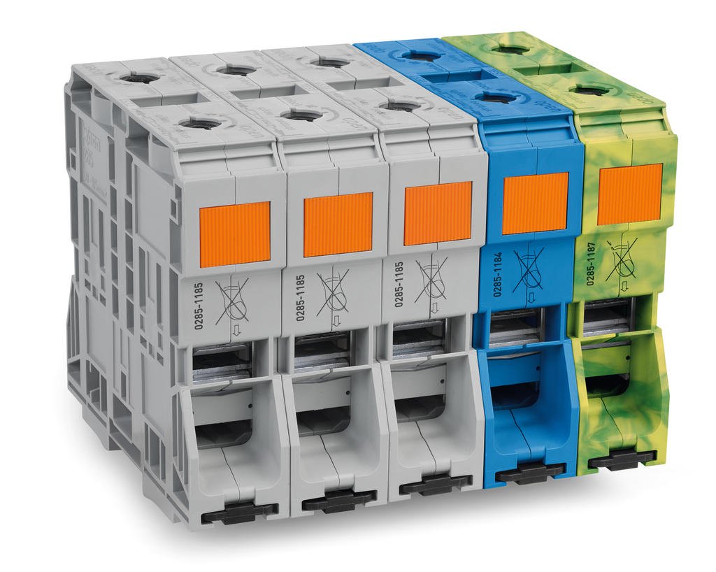

Трехфазный комплект; с клеммной колодкой высокого тока 185 мм²; только для рейки DIN 35 x 15; медь; 185 мм²; POWER CAGE CLAMP

| Actuation type | Operating tool |
| Цвет | gray, blue, green-yellow |
| Connectable conductor materials | Copper |
| Connection technology | POWER CAGE CLAMP |
| Country of origin | DE |
| Габариты: глубина | 130 mm / 5.118 inch |
| Design | horizontal |
| Fine-stranded conductor | 50 … 185 mm² / 1/0 AWG … 350 kcmil |
| Fine-stranded conductor with ferrule with plastic collar | 50 … 150 mm² / 1/0 AWG … 250 kcmil |
| Fine-stranded conductor with ferrule without plastic collar | 50 … 185 mm² / 1/0 AWG … 350 kcmil |
| GTIN | 4055143074322 |
| Height from upper-edge of DIN-35 rail | 116 mm / 4.567 inch |
| Insulating material | Polyamide 66 (PA 66) |
| Marking level | Side marking |
| Nominal cross section | 185 mm² |
| Number of levels | 1 |
| Product Group | 1 (Rail Mounted Terminal Blocks) |
| Rated impulse voltage (III / 3) | 12 kV |
| Rated impulse voltage (III / 3) 2 | 12 kV |
| Rated voltage (III / 3) | 1000 В |
| Rated voltage (III / 3) 2 | 1500 В |
| Solid conductor | 50 … 185 mm² / 1/0 AWG … 350 kcmil |
| Stranded conductor | 50 … 185 mm² / 1/0 AWG … 350 kcmil |
| Strip length | 45 … 47 mm / 1.77 … 1.85 Inch |
| Total number of connection points | 10 |
| Total number of potentials | 5 |
| Type of mounting | DIN-35 rail |
| Type of wiring | Side-entry wiring |
| Вес | 2764.95 г |
