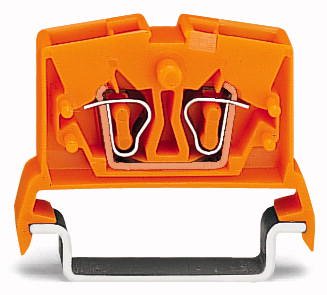

Datasheet Wago 264-716 — Даташит
2-проводная миниатюрная проходная клеммная колодка; 2,5 мм²; с возможностью тестирования; маркировка центра; для DIN-рейки 35 x 15 и 35 x 7,5; CAGE CLAMP

| Actuation type | Operating tool |
| Цвет | orange |
| Connectable conductor materials | Copper |
| Connection technology | CAGE CLAMP® |
| Country of origin | CH |
| Габариты: глубина | 38 mm / 1.496 inch |
| Design | horizontal |
| Fine-stranded conductor | 0.08 … 2.5 mm² / 28 … 12 AWG |
| Fire load | 0.075 MJ |
| GTIN | 4044918415460 |
| Height from upper-edge of DIN-35 rail | 24.5 mm / 0.965 inch |
| Legend (ratings) | (III / 3) ≙ Overvoltage category III / Pollution degree 3 |
| Marking level | Center marking |
| Number of levels | 1 |
| Product Group | 9 (Std. Chassis Mt. Blocks) |
| Rated current | 24 A |
| Rated impulse voltage (III / 3) | 8 kV |
| Rated voltage (III / 3) | 800 В |
| Solid conductor | 0.08 … 2.5 mm² / 28 … 12 AWG |
| Strip length | 8 … 9 mm / 0.31 … 0.35 Inch |
| Total number of connection points | 2 |
| Total number of potentials | 1 |
| Type of mounting | DIN-35 rail |
| Type of wiring | Front-entry wiring |
| Вес | 3.876 г |
| Ширина | 6 mm / 0.236 inch |
