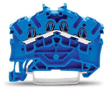

Datasheet Wago 2002-6404 — Даташит
Проходная клеммная колодка TOPJOB S; угловой профиль; монтаж на рейку; 4-проводная; ширина 5,2 мм; синяя
![]() 6 предложений от 3 поставщиков Клеммные Колодки на DIN-рейку | |||
2002-6404 Wago | 137 ₽ | ||
2002-6404 Wago | от 591 ₽ | ||
2002-6404 Wago | по запросу |
Actuation type | Open Tool Slot |
Цвет | blue |
Connectable conductor materials | Copper |
Connection technology | Push-in CAGE CLAMP® |
Country of origin | CN |
Габариты: глубина | 51.3 mm / 2.031 inch |
Design | angled |
Fine-stranded conductor | 0.25 … 4 mm² / 22 … 12 AWG |
Fine-stranded conductor with ferrule, push-in termination, from | 0.75 mm² / 18 AWG |
Fire load | 0.122 MJ |
GTIN | 4044918964906 |
Height from upper-edge of DIN-35 rail | 38.9 mm / 1.531 inch |
Marking level | Center/side marking |
Nominal cross section | 2.5 mm² |
Number of levels | 1 |
Product Group | 22 (TOPJOB S) |
Rated current (Ex e II) | 22 A |
Rated current (Ex e II) with jumper | 20 A |
Rated voltage EN (Ex e II) | 550 В |
Solid conductor | 0.25 … 4 mm² / 22 … 12 AWG |
Solid conductor, push-in termination | 0.75 … 4 mm² / 18 … 12 AWG |
Strip length | 10 … 12 mm / 0.39 … 0.47 Inch |
Total number of connection points | 4 |
Total number of potentials | 1 |
Type of mounting | DIN-35 rail |
Type of wiring | Front-entry wiring |
Вес | 5.86 г |
Ширина | 5.2 mm / 0.205 inch |
