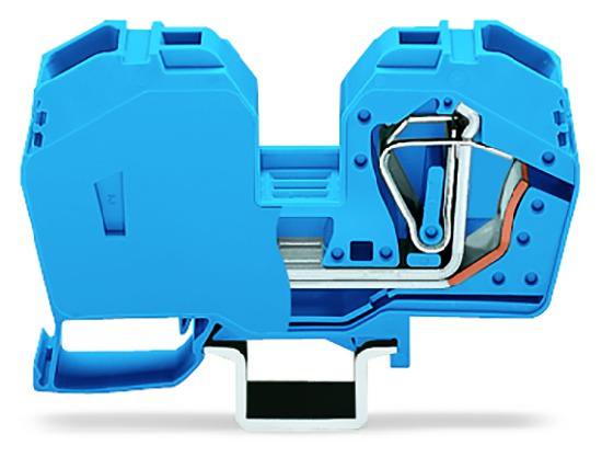

2-проводная проходная клеммная колодка; 35 мм²; со встроенной торцевой пластиной; боковая и центральная маркировка; только для рейки DIN 35 x 15; толщина 2,3 мм; медь; CAGE CLAMP

Actuation type | Operating tool |
Цвет | blue |
Connectable conductor materials | Copper |
Connection technology | CAGE CLAMP® |
Country of origin | PL |
Габариты: глубина | 100 mm / 3.937 inch |
Design | horizontal |
Fine-stranded conductor | 6 … 35 mm² / 8 … 2 AWG |
Fire load | 1.082 MJ |
GTIN | 4045454218706 |
Height from upper-edge of DIN-35 rail | 53 mm / 2.087 inch |
Legend (ratings) | (III / 3) ≙ Overvoltage category III / Pollution degree 3 |
Marking level | Center/side marking |
Nominal cross section | 35 mm² |
Number of levels | 1 |
Product Group | 1 (Rail Mounted Terminal Blocks) |
Rated current | 125 A |
Rated impulse voltage (III / 3) | 8 kV |
Rated voltage (III / 3) | 1000 В |
Solid conductor | 6 … 35 mm² / 8 … 2 AWG |
Strip length | 23 mm / 0.91 Inch |
Total number of connection points | 2 |
Total number of potentials | 1 |
Type of mounting | DIN-35 rail |
Type of wiring | Front-entry wiring |
Вес | 87.5 г |
Ширина | 16 mm / 0.63 inch |
