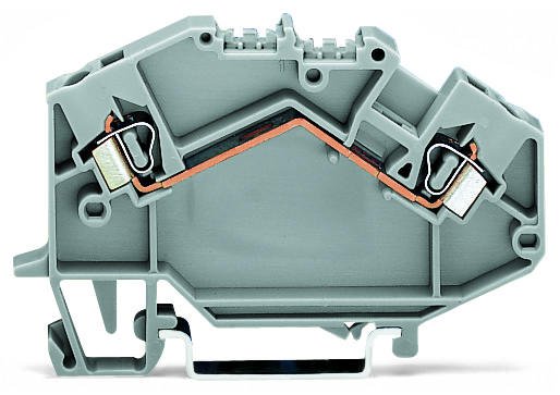

Actuation typeOperating tool
Цветgray
Connectable conductor materialsCopper
Connection technologyCAGE CLAMP®
Country of originDE
Габариты: глубина77 mm / 3.031 inch
Designangled
Fine-stranded conductor0.08 … 2.5 mm² / 28 … 12 AWG
Fire load0.174 MJ
GTIN4044918681018
Height from upper-edge of DIN-35 rail43.5 mm / 1.713 inch
Insulating materialPolyamide 66 (PA 66)
Legend (ratings)(III / 3) ≙ Overvoltage category III / Pollution degree 3
Marking levelCenter marking
Number of levels1
Rated current24 A
Rated impulse voltage (III / 3)8 kV
Rated voltage (III / 3)1000 В
Solid conductor0.08 … 2.5 mm² / 28 … 12 AWG
Strip length8 … 9 mm / 0.31 … 0.35 Inch
Total number of connection points2
Total number of potentials1
Type of mountingDIN-35 rail
Type of wiringFront-entry wiring
Вес8.58 г
Ширина5 mm / 0.197 inch
