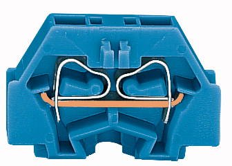

Actuation type | Operating tool |
Цвет | blue |
Connectable conductor materials | Copper |
Connection technology | CAGE CLAMP® |
Country of origin | CH |
Габариты: глубина | 25 mm / 0.984 inch |
Design | horizontal |
Fine-stranded conductor | 0.08 … 1.5 mm² / 28 … 16 AWG |
Fire load | 0.032 MJ |
GTIN | 4044918593427 |
Height from the surface | 17 mm / 0.669 inch |
Legend (ratings) | (III / 3) ≙ Overvoltage category III / Pollution degree 3 |
Marking level | Side marking |
Mounting type | Mounting flange |
Number of levels | 1 |
Product Group | 9 (Std. Chassis Mt. Blocks) |
Rated current | 18 A |
Rated impulse voltage (III / 3) | 6 kV |
Rated voltage (III / 3) | 400 В |
Solid conductor | 0.08 … 1.5 mm² / 28 … 16 AWG |
Strip length | 8 … 9 mm / 0.31 … 0.35 Inch |
Total number of connection points | 2 |
Total number of potentials | 1 |
Type of wiring | Side-entry wiring |
Вес | 1.602 г |
Ширина | 5 mm / 0.197 inch |
