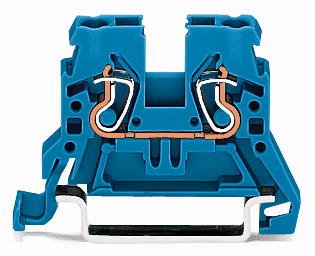

2-проводная проходная клеммная колодка; 2,5 мм²; подходит для применений Ex i; боковая и центральная маркировка; для DIN-рейки 35 x 15 и 35 x 7,5; CAGE CLAMP

| Actuation type | Operating tool |
| Цвет | blue |
| Connectable conductor materials | Copper |
| Connection technology | CAGE CLAMP® |
| Country of origin | DE |
| Габариты: глубина | 44.5 mm / 1.752 inch |
| Design | horizontal |
| Fine-stranded conductor | 0.08 … 4 mm² / 28 … 12 AWG |
| Fire load | 0.08 MJ |
| GTIN | 4044918478380 |
| Height from upper-edge of DIN-35 rail | 27.5 mm / 1.083 inch |
| Insulating material | Polyamide 66 (PA 66) |
| Legend (ratings) | (III / 3) ≙ Overvoltage category III / Pollution degree 3 |
| Marking level | Side marking |
| Number of levels | 1 |
| Product Group | 16 (Rail Mounted Terminal Block with CCC) |
| Rated current | 24 A |
| Rated impulse voltage (III / 3) | 6 kV |
| Rated voltage (III / 3) | 500 В |
| Solid conductor | 0.08 … 2.5 mm² / 28 … 12 AWG |
| Strip length | 6 … 7 mm / 0.24 … 0.28 Inch |
| Total number of connection points | 2 |
| Total number of potentials | 1 |
| Type of mounting | DIN-35 rail |
| Type of wiring | Front-entry wiring |
| Вес | 4.313 г |
| Ширина | 5 mm / 0.197 inch |
