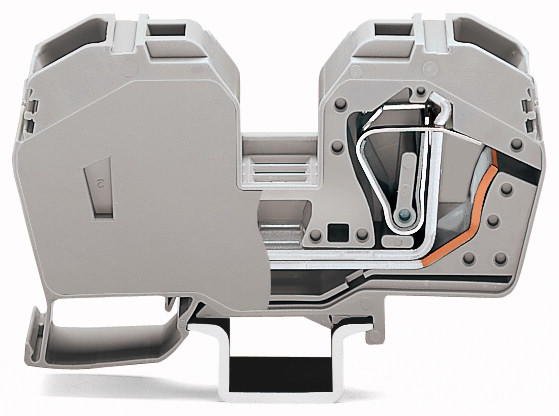

2-проводная проходная клеммная колодка; 35 мм²; со встроенной торцевой пластиной; подходит для применений Ex e II; боковая и центральная маркировка; только для рейки DIN 35 x 15; толщина 2,3 мм; медь; CAGE CLAMP

| Actuation type | Operating tool |
| Цвет | light gray |
| Connectable conductor materials | Copper |
| Connection technology | CAGE CLAMP® |
| Country of origin | PL |
| Габариты: глубина | 100 mm / 3.937 inch |
| Design | horizontal |
| Fine-stranded conductor | 6 … 35 mm² / 8 … 2 AWG |
| Fire load | 1.067 MJ |
| GTIN | 4055143256995 |
| Height from upper-edge of DIN-35 rail | 53 mm / 2.087 inch |
| Insulating material | Polyamide 66 (PA 66) |
| Marking level | Center/side marking |
| Nominal cross section | 35 mm² |
| Number of levels | 1 |
| Product Group | 1 (Rail Mounted Terminal Blocks) |
| Rated voltage EN (Ex e II) | 880 В |
| Solid conductor | 6 … 35 mm² / 8 … 2 AWG |
| Strip length | 23 mm / 0.91 Inch |
| Total number of connection points | 2 |
| Total number of potentials | 1 |
| Type of mounting | DIN-35 rail |
| Type of wiring | Front-entry wiring |
| Вес | 87.004 г |
| Ширина | 16 mm / 0.63 inch |
