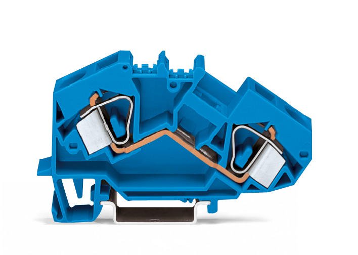

2-проводная проходная клеммная колодка; 16 мм²; маркировка центра; для DIN-рейки 35 x 15 и 35 x 7,5; CAGE CLAMP
Augswan
783-604
Wago
Actuation typeOperating tool
Цветblue
Connectable conductor materialsCopper
Connection technologyCAGE CLAMP®
Country of originDE
Габариты: глубина88.5 mm / 3.484 inch
Designangled
Fine-stranded conductor0.2 … 16 mm² / 24 … 6 AWG
Fire load0.489 MJ
GTIN4044918582407
Height from upper-edge of DIN-35 rail43.5 mm / 1.713 inch
Insulating materialPolyamide 66 (PA 66)
Legend (ratings)(III / 3) ≙ Overvoltage category III / Pollution degree 3
Marking levelCenter marking
Number of levels1
Rated current76 A
Rated impulse voltage (III / 3)8 kV
Rated voltage (III / 3)1000 В
Solid conductor0.2 … 16 mm² / 24 … 6 AWG
Strip length16 … 17 mm / 0.63 … 0.67 Inch
Total number of connection points2
Total number of potentials1
Type of mountingDIN-35 rail
Type of wiringFront-entry wiring
Вес32.204 г
Ширина12 mm / 0.472 inch
