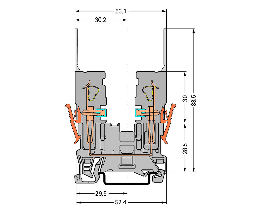

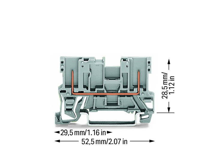

Габариты: глубина | 52.5 mm / 2.067 inch |
Design | horizontal |
Fire load | 0.099 MJ |
GTIN | 4044918391672 |
Height from upper-edge of DIN-35 rail | 28.5 mm / 1.122 inch |
