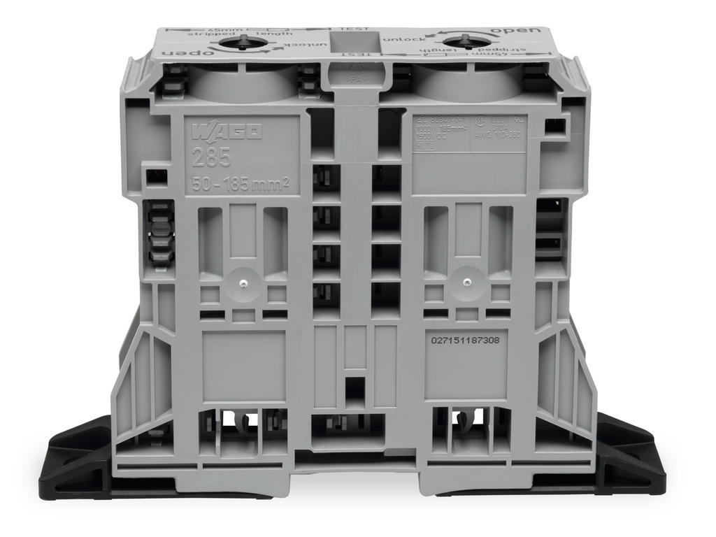

Actuation type | Operating tool |
Цвет | gray |
Connectable conductor materials | Copper |
Connection technology | POWER CAGE CLAMP |
Country of origin | DE |
Габариты: глубина | 170 mm / 6.693 inch |
Design | horizontal |
Fine-stranded conductor | 50 … 185 mm² / 1/0 AWG … 350 kcmil |
Fine-stranded conductor with ferrule with plastic collar | 50 … 150 mm² / 1/0 AWG … 300 kcmil |
Fine-stranded conductor with ferrule without plastic collar | 50 … 185 mm² / 1/0 AWG … 350 kcmil |
GTIN | 4055143424141 |
Height | 123 mm / 4.843 inch |
Height from the surface | 123 mm / 4.843 inch |
Legend (ratings) | (III / 3) ≙ Overvoltage category III / Pollution degree 3 |
Marking level | Side marking |
Mounting type | Mounting flange |
Nominal cross section | 185 mm² |
Number of levels | 1 |
Rated current | 353 A |
Rated impulse voltage (III / 3) | 12 kV |
Rated impulse voltage (III / 3) 2 | 12 kV |
Rated voltage (III / 3) | 1000 В |
Rated voltage (III / 3) 2 | 1500 В |
Solid conductor | 50 … 185 mm² / 1/0 AWG … 350 kcmil |
Stranded conductor | 50 … 185 mm² / 1/0 AWG … 350 kcmil |
Strip length | 45 … 47 mm / 1.77 … 1.85 Inch |
Total number of connection points | 2 |
Total number of potentials | 1 |
Type of wiring | Side-entry wiring |
Вес | 552 г |
Ширина | 32 mm / 1.26 inch |
