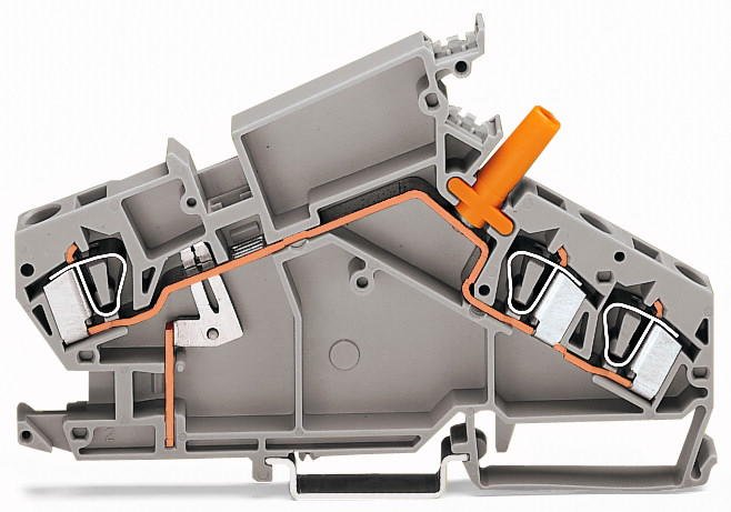

Datasheet Wago 282-865 — Даташит
3-проводная проходная клеммная колодка; 6 мм²; с защищенным от прикосновения тестовым гнездом; например, цепи трансформатора тока; маркировка центра; для DIN-рейки 35 x 15 и 35 x 7,5; CAGE CLAMP

Actuation type | Operating tool |
Цвет | gray |
Connectable conductor materials | Copper |
Connection technology | CAGE CLAMP® |
Country of origin | CN |
Габариты: глубина | 122 mm / 4.803 inch |
Design | angled |
Fine-stranded conductor | 0.2 … 6 mm² / 24 … 10 AWG |
Fire load | 0.615 MJ |
GTIN | 4044918754224 |
Height from upper-edge of DIN-35 rail | 74 mm / 2.913 inch |
Legend (ratings) | (III / 3) ≙ Overvoltage category III / Pollution degree 3 |
Marking level | Center marking |
Number of levels | 1 |
Product Group | 1 (Rail Mounted Terminal Blocks) |
Rated current | 30 A |
Rated impulse voltage (III / 3) | 6 kV |
Rated voltage (III / 3) | 500 В |
Solid conductor | 0.2 … 6 mm² / 24 … 10 AWG |
Strip length | 12 … 13 mm / 0.47 … 0.51 Inch |
Total number of connection points | 3 |
Total number of potentials | 1 |
Type of mounting | DIN-35 rail |
Type of wiring | Front-entry wiring |
Вес | 38.608 г |
Ширина | 8 mm / 0.315 inch |
