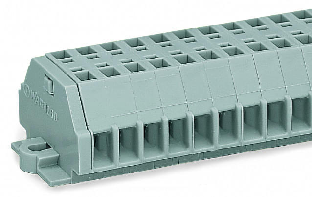

| Actuation type | Operating tool |
| Цвет | gray |
| Connectable conductor materials | Copper |
| Connection technology | CAGE CLAMP® |
| Country of origin | DE |
| Габариты: глубина | 25 mm / 0.984 inch |
| Design | horizontal |
| Fine-stranded conductor | 0.08 … 1.5 mm² / 28 … 16 AWG |
| Fire load | 0.091 MJ |
| GTIN | 4044918598767 |
| Height from the surface | 17 mm / 0.669 inch |
| Legend (ratings) | (III / 3) ≙ Overvoltage category III / Pollution degree 3 |
| Marking level | Side marking |
| Mounting type | Mounting flange |
| Number of Poles | 2 |
| Number of levels | 1 |
| Rated current | 18 A |
| Rated impulse voltage (III / 3) | 6 kV |
| Rated voltage (III / 3) | 400 В |
| Solid conductor | 0.08 … 1.5 mm² / 28 … 16 AWG |
| Strip length | 8 … 9 mm / 0.31 … 0.35 Inch |
| Total number of connection points | 4 |
| Total number of potentials | 2 |
| Type of wiring | Side-entry wiring |
| Вес | 4.38 г |
| Ширина | 24.5 mm / 0.965 inch |
