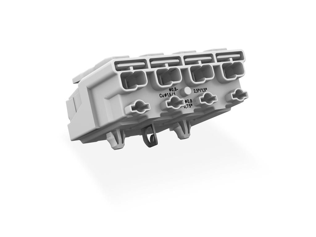

Разъем питания; с прямым заземляющим контактом; с защелкивающимися монтажными ножками; 1-2-PE-N; 4-полюсный
| Actuation type | Operating tool Push-button |
| Clamping spring material | Chrome nickel spring steel (CrNi) |
| Цвет | white |
| Connectable conductor materials | Copper |
| Connection technology | Push-in CAGE CLAMP® |
| Connection technology 2 | PUSH WIRE® |
| Connection type (1) | External 1 |
| Connection type (2) | Internal 2 |
| Connection type (3) | Internal 3 |
| Connection type (4) | Internal 4 |
| Contact material | Electrolytic copper (Ecu) |
| Contact plating | tin-plated |
| Country of origin | CH |
| Габариты: глубина | 27.3 mm / 1.075 inch |
| Fine-stranded conductor | 0.5 … 2.5 mm² / 18 … 14 AWG |
| Fine-stranded conductor with ferrule with plastic collar | 0.5 … 1.5 mm² / 18 … 16 AWG |
| Fine-stranded conductor with ferrule without plastic collar | 0.5 … 1.5 mm² / 18 … 16 AWG |
| Fine-stranded conductor with ferrule, push-in termination, from | 0.5 mm² / 18 AWG |
| Fine-stranded conductor with insulated ferrule (2) | 0.5 … 1 mm² / 18 … 16 AWG |
| Fine-stranded conductor with insulated ferrule (3) | 0.5 … 0.75 mm² / 18 AWG |
| Fine-stranded conductor with uninsulated ferrule (2) | 0.5 … 1.5 mm² / 18 … 14 AWG |
| Fine-stranded conductor with uninsulated ferrule (3) | 0.5 … 1 mm² / 18 AWG |
| Fire load | 0.242 MJ |
| Flammability class per UL94 | V0 |
| GTIN | 4050821098331 |
| Ground function | with direct GND contact |
| Height from the surface | 17 mm / 0.669 inch |
| Insulating material | Polycarbonate (PC) |
| Legend (ratings) | (III / 3) ≙ Overvoltage category III / Pollution degree 3 |
| Marking | 1-2-PE-N |
| Material group | III a |
| Mounting type | Snap-in mounting foot |
| Number of Poles | 4 |
| Number of connection points | 1 |
| Number of connection points (connection type) | 2 |
| Number of connection types | 4 |
| Product Group | 8 (Misc. Chassis Mount Blocks) |
| Rated current | 24 A |
| Rated current (2) | 24 A |
| Rated current (3) | 16 A |
| Rated impulse voltage (II / 2) | 4 kV |
| Rated impulse voltage (II / 2) 2 | 4 kV |
| Rated voltage (II / 2) | 500 В |
| Rated voltage (II / 2) 2 | 500 В |
| Ratings according to 2 | IEC/EN 60998-2-2 |
| Ratings note | Connection points |
| Ratings note 2 | Connection points |
| Solid conductor | 0.5 … 2.5 mm² / 18 … 12 AWG |
| Solid conductor (2) | 0.5 … 2.5 mm² / 18 … 14 AWG |
| Solid conductor (3) | 0.5 … 1.5 mm² / 18 … 16 AWG |
| Solid conductor (4) | 0.5 … 0.75 mm² / 18 AWG |
| Solid conductor, push-in termination | 0.5 … 2.5 mm² / 18 … 12 AWG |
| Stranded conductor | 0.5 … 2.5 mm² / 18 … 14 AWG |
| Strip length | 8 … 9 mm / 0.31 … 0.35 Inch |
| Strip length (2) | 8 … 9 mm / 0.31 … 0.35 Inch |
| Temperature stability | 120 °C |
| Total number of connection points | 20 |
| Total number of potentials | 4 |
| Type of wiring | Side-entry wiring |
| Вес | 12.447 г |
