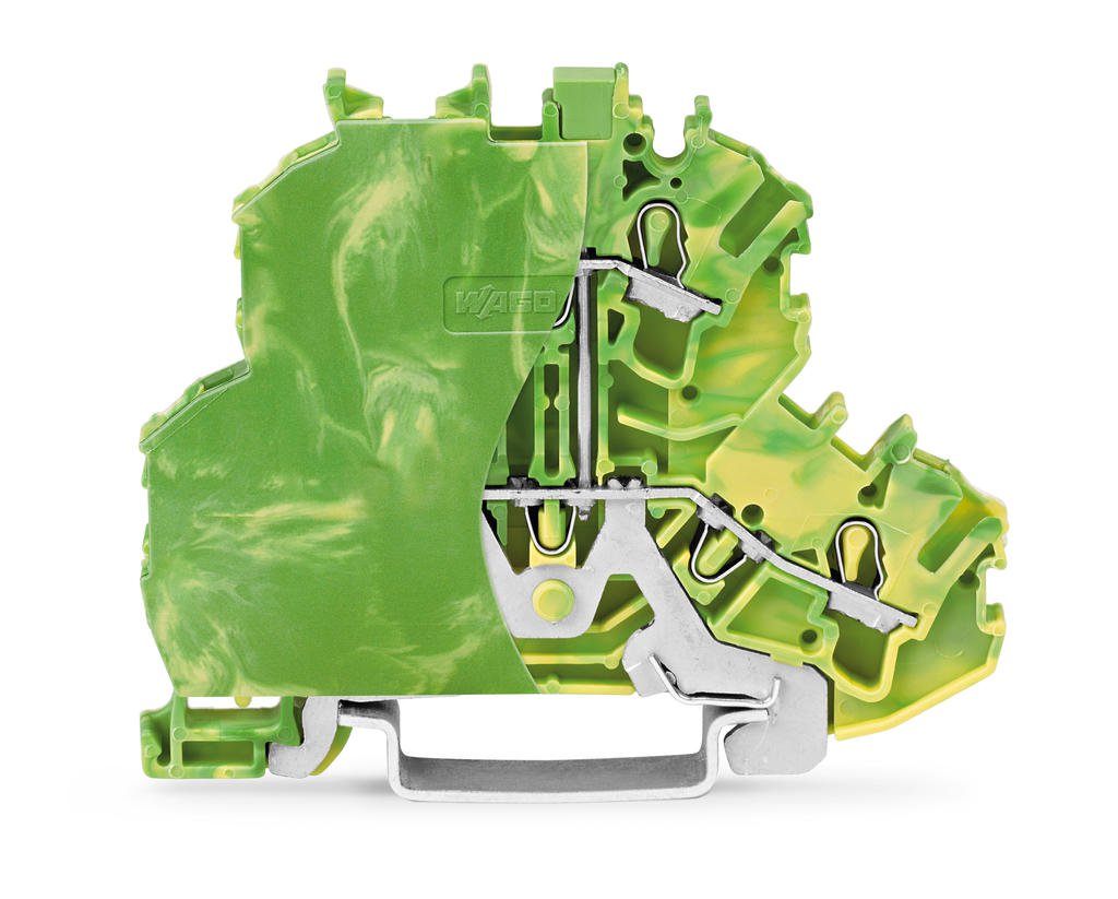

Двухуровневая клеммная колодка заземления TOPJOB S; с внутренним объединением; с серым разделителем; монтаж на рейку; 4-проводная; ширина 6,2 мм; желто-зеленая
DOUBLE-DECK TERMINAL BLOCK; 4-CO | |||
| 2002-2207/099-000 Wago | по запросу | ||
| Actuation type | Open Tool Slot |
| Цвет | green-yellow |
| Connectable conductor materials | Copper |
| Connection technology | Push-in CAGE CLAMP® |
| Country of origin | DE |
| Габариты: глубина | 69.7 mm / 2.744 inch |
| Design | horizontal |
| Fine-stranded conductor | 0.25 … 4 mm² / 22 … 12 AWG |
| Fine-stranded conductor with ferrule, push-in termination, from | 0.75 mm² / 18 AWG |
| Fire load | 0.297 MJ |
| GTIN | 4050821266419 |
| Height from upper-edge of DIN-35 rail | 51.7 mm / 2.035 inch |
| Insulating material | Polyamide 66 (PA 66) |
| Marking level | Center/side marking |
| Nominal cross section | 2.5 mm² |
| Number of levels | 2 |
| Potential marking | PE |
| Solid conductor | 0.25 … 4 mm² / 22 … 12 AWG |
| Solid conductor, push-in termination | 0.75 … 4 mm² / 18 … 12 AWG |
| Strip length | 10 … 12 mm / 0.39 … 0.47 Inch |
| Total number of connection points | 4 |
| Total number of potentials | 1 |
| Type of mounting | DIN-35 rail |
| Type of wiring | Front-entry wiring |
| Вес | 16.553 г |
| Ширина | 6.2 mm / 0.244 inch |
