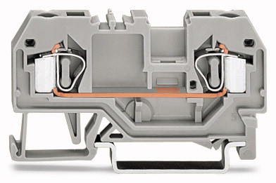

Datasheet Wago 281-905 — Даташит
2-проводная проходная клеммная колодка; 4 мм²; маркировка центра; для DIN-рейки 35 x 15 и 35 x 7,5; CAGE CLAMP
Купить 281-905 на РадиоЛоцман.Цены — от 128 до 971 ₽11 предложений от 8 поставщиков , 800V 32A 28AWG 12AWG Black 2Pole Through Terminal Block | |||
| 281-905 Wago | 128 ₽ | ||
| 281-905 | по запросу | ||
| 281905-1-1 | по запросу | ||
| Actuation type | Operating tool |
| Цвет | black |
| Connectable conductor materials | Copper |
| Connection technology | CAGE CLAMP® |
| Country of origin | DE |
| Габариты: глубина | 59 mm / 2.323 inch |
| Design | horizontal |
| Fine-stranded conductor | 0.08 … 4 mm² / 28 … 12 AWG |
| Fire load | 0.145 MJ |
| GTIN | 4044918485135 |
| Height from upper-edge of DIN-35 rail | 29 mm / 1.142 inch |
| Insulating material | Polyamide 66 (PA 66) |
| Legend (ratings) | (III / 3) ≙ Overvoltage category III / Pollution degree 3 |
| Marking level | Center marking |
| Number of levels | 1 |
| Rated current | 32 A |
| Rated impulse voltage (III / 3) | 8 kV |
| Rated voltage (III / 3) | 800 В |
| Solid conductor | 0.08 … 4 mm² / 28 … 12 AWG |
| Strip length | 9 … 10 mm / 0.35 … 0.39 Inch |
| Total number of connection points | 2 |
| Total number of potentials | 1 |
| Type of mounting | DIN-35 rail |
| Type of wiring | Front-entry wiring |
| Вес | 7.944 г |
| Ширина | 6 mm / 0.236 inch |
