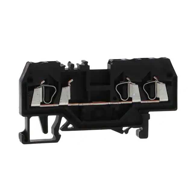

Datasheet Wago 280-671 — Даташит
3-проводная проходная клеммная колодка; 2,5 мм²; маркировка центра; для DIN-рейки 35 x 15 и 35 x 7,5; CAGE CLAMP

Actuation type | Operating tool |
Цвет | black |
Connectable conductor materials | Copper |
Connection technology | CAGE CLAMP® |
Country of origin | DE |
Габариты: глубина | 64 mm / 2.52 inch |
Design | horizontal |
Fine-stranded conductor | 0.08 … 2.5 mm² / 28 … 12 AWG |
Fire load | 0.123 MJ |
GTIN | 4044918391221 |
Height from upper-edge of DIN-35 rail | 28 mm / 1.102 inch |
Legend (ratings) | (III / 3) ≙ Overvoltage category III / Pollution degree 3 |
Marking level | Center marking |
Number of levels | 1 |
Rated current | 24 A |
Rated impulse voltage (III / 3) | 8 kV |
Rated voltage (III / 3) | 800 В |
Solid conductor | 0.08 … 2.5 mm² / 28 … 12 AWG |
Strip length | 8 … 9 mm / 0.31 … 0.35 Inch |
Total number of connection points | 3 |
Total number of potentials | 1 |
Type of mounting | DIN-35 rail |
Type of wiring | Front-entry wiring |
Вес | 7.576 г |
Ширина | 5 mm / 0.197 inch |
