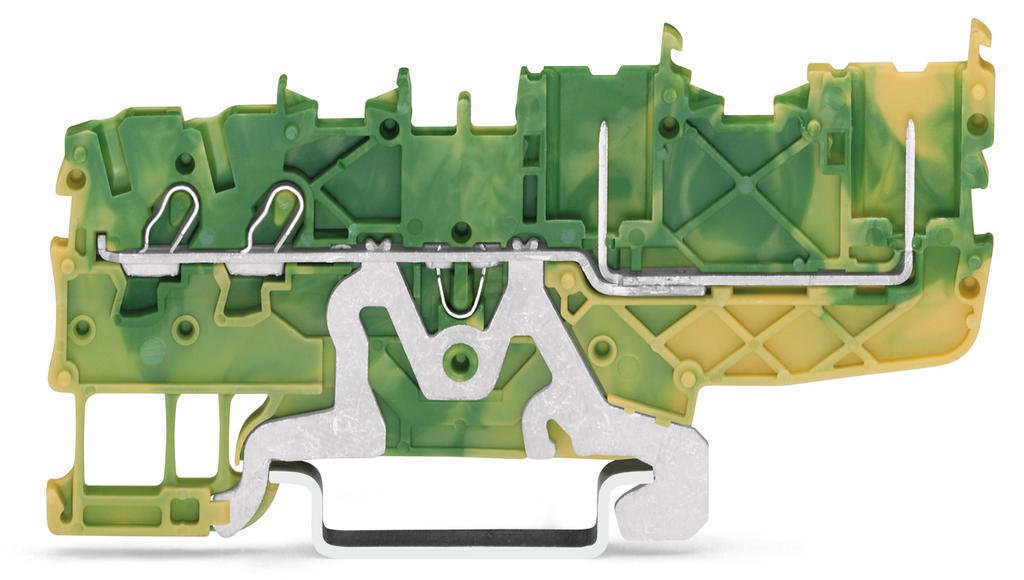

Datasheet Wago 2020-1407 — Даташит
X-COM S-Mini заземляющий/проходной клеммный блок; монтаж на рейку; 2-проводной, 2-контактный; ширина 3,5 мм; желто-зеленый
![]() 14 предложений от 4 поставщиков 2-CONDUCTOR/2-PIN GROUND CARRIER | |||
2020-1407 | от 664 ₽ | ||
2020-1407 Wago | от 811 ₽ | ||
2020-1407 Wago | 2 561 ₽ | ||
2020-1407 Wago | по запросу |
Actuation type | Open Tool Slot |
Цвет | green-yellow |
Connectable conductor materials | Copper |
Connection technology | Push-in CAGE CLAMP® |
Country of origin | CN |
Габариты: глубина | 85.2 mm / 3.354 inch |
Design | horizontal |
Fine-stranded conductor | 0.14 … 1.5 mm² / 24 … 16 AWG |
Fine-stranded conductor with ferrule, push-in termination, from | 0.5 mm² / 20 AWG |
Fire load | 0.128 MJ |
GTIN | 4050821145295 |
Height from upper-edge of DIN-35 rail | 32.5 mm / 1.28 inch |
Marking level | Center/side marking |
Nominal cross section | 1 mm² |
Number of levels | 1 |
Product Group | 18 (X-COM-System) |
Solid conductor | 0.14 … 1.5 mm² / 24 … 16 AWG |
Solid conductor, push-in termination | 0.5 … 1.5 mm² / 20 … 16 AWG |
Strip length | 9 … 11 mm / 0.35 … 0.43 Inch |
Total number of connection points | 2 |
Total number of potentials | 1 |
Type of mounting | DIN-35 rail |
Type of wiring | Front-entry wiring |
Вес | 8.65 г |
Ширина | 3.5 mm / 0.138 inch |
