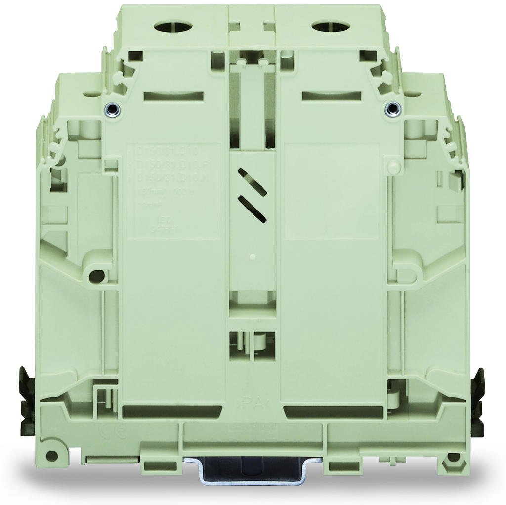

Клеммная колодка винтового типа; 150 мм²
400-499/499-715, 2-конт. зажим, 150 мм2 | |||
400-499/499-715 Wago Оф. дистрибьютор | по запросу |
Actuation type | Operating tool |
Цвет | light gray |
Connectable conductor materials | Copper |
Connection technology | Screw-clamp connection/Studs |
Country of origin | FR |
Габариты: глубина | 119.4 mm / 4.701 inch |
Design | horizontal |
GTIN | 4045454224509 |
Height from upper-edge of DIN-35 rail | 114.5 mm / 4.508 inch |
Legend (ratings) | (III / 3) ≙ Overvoltage category III / Pollution degree 3 |
Marking level | Side marking |
Number of levels | 1 |
Rated current | 309 A |
Rated impulse voltage (III / 3) | 8 kV |
Rated voltage (III / 3) | 1000 В |
Solid conductor | 35 … 150 mm² / 2 AWG … 300 kcmil |
Strip length | 35 mm / 1.38 Inch |
Total number of connection points | 2 |
Total number of potentials | 1 |
Type of mounting | DIN-35 rail |
Type of wiring | Side-entry wiring |
Вес | 383 г |
Ширина | 31 mm / 1.22 inch |
