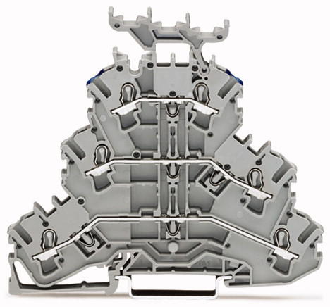

Клеммная колодка TOPJOB S с тремя уровнями; проходная/проходная/проходная (L/L/N); с держателем маркера; монтаж на рейку; 2-проводная; ширина 5,2 мм; серая

| Actuation type | Open Tool Slot |
| Цвет | gray |
| Connectable conductor materials | Copper |
| Connection technology | Push-in CAGE CLAMP® |
| Country of origin | DE |
| Габариты: глубина | 93.3 mm / 3.673 inch |
| Design | horizontal |
| Fine-stranded conductor | 0.25 … 4 mm² / 22 … 12 AWG |
| Fine-stranded conductor with ferrule, push-in termination, from | 0.75 mm² / 18 AWG |
| Fire load | 0.336 MJ |
| GTIN | 4044918989749 |
| Height from upper-edge of DIN-35 rail | 81.3 mm / 3.201 inch |
| Insulating material | Polyamide 66 (PA 66) |
| Marking level | Center/side marking |
| Nominal cross section | 2.5 mm² |
| Number of connection points | 3 |
| Number of connection points (connection type) | 3 |
| Number of levels | 3 |
| Potential marking | L/L/N |
| Product Group | 22 (TOPJOB S) |
| Rated current (Ex e II) | 19 A |
| Rated current (Ex e II) with jumper | 17 A |
| Rated voltage EN (Ex e II) | 440 В |
| Solid conductor | 0.25 … 4 mm² / 22 … 12 AWG |
| Solid conductor, push-in termination | 0.75 … 4 mm² / 18 … 12 AWG |
| Strip length | 10 … 12 mm / 0.39 … 0.47 Inch |
| Total number of connection points | 6 |
| Total number of potentials | 3 |
| Type of mounting | DIN-35 rail |
| Type of wiring | Front-entry wiring |
| Вес | 17.528 г |
| Ширина | 5.2 mm / 0.205 inch |
