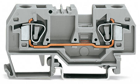

Datasheet Wago 282-902 — Даташит
2-проводная проходная клеммная колодка; 6 мм²; маркировка центра; для DIN-рейки 35 x 15 и 35 x 7,5; CAGE CLAMP

Actuation type | Operating tool |
Цвет | orange |
Connectable conductor materials | Copper |
Connection technology | CAGE CLAMP® |
Country of origin | DE |
Габариты: глубина | 74.5 mm / 2.933 inch |
Design | horizontal |
Fine-stranded conductor | 0.2 … 6 mm² / 24 … 10 AWG |
Fire load | 0.267 MJ |
GTIN | 4044918445849 |
Height from upper-edge of DIN-35 rail | 32.5 mm / 1.28 inch |
Legend (ratings) | (III / 3) ≙ Overvoltage category III / Pollution degree 3 |
Marking level | Center marking |
Number of levels | 1 |
Rated current | 41 A |
Rated impulse voltage (III / 3) | 8 kV |
Rated voltage (III / 3) | 800 В |
Solid conductor | 0.2 … 6 mm² / 24 … 10 AWG |
Strip length | 12 … 13 mm / 0.47 … 0.51 Inch |
Total number of connection points | 2 |
Total number of potentials | 1 |
Type of mounting | DIN-35 rail |
Type of wiring | Front-entry wiring |
Вес | 15.906 г |
Ширина | 8 mm / 0.315 inch |
