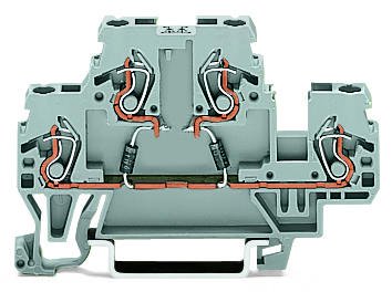

Двухъярусная диодная клеммная колодка; с 2 диодами 1N4007
COMPONENT TERMINAL BLOCK; DOUBLE | |||
870-542/281-488 Wago | по запросу | ||
870-542/281-488 | по запросу |
Actuation type | Operating tool |
Цвет | gray |
Connectable conductor materials | Copper |
Connection technology | CAGE CLAMP® |
Country of origin | DE |
Габариты: глубина | 70 mm / 2.756 inch |
Design | horizontal |
Fine-stranded conductor | 0.08 … 4 mm² / 28 … 12 AWG |
Fire load | 0.192 MJ |
GTIN | 4045454198695 |
Height from upper-edge of DIN-35 rail | 40 mm / 1.575 inch |
Marking level | Side marking |
Nominal voltage | 250 В |
Number of levels | 2 |
Product Group | 16 (Rail Mounted Terminal Block with CCC) |
Reverse voltage | 1000 В |
Solid conductor | 0.08 … 2.5 mm² / 28 … 12 AWG |
Strip length | 6 … 7 mm / 0.24 … 0.28 Inch |
Total number of connection points | 4 |
Total number of potentials | 1 |
Type of mounting | DIN-35 rail |
Type of wiring | Front-entry wiring |
Вес | 9.7 г |
Ширина | 5 mm / 0.197 inch |
