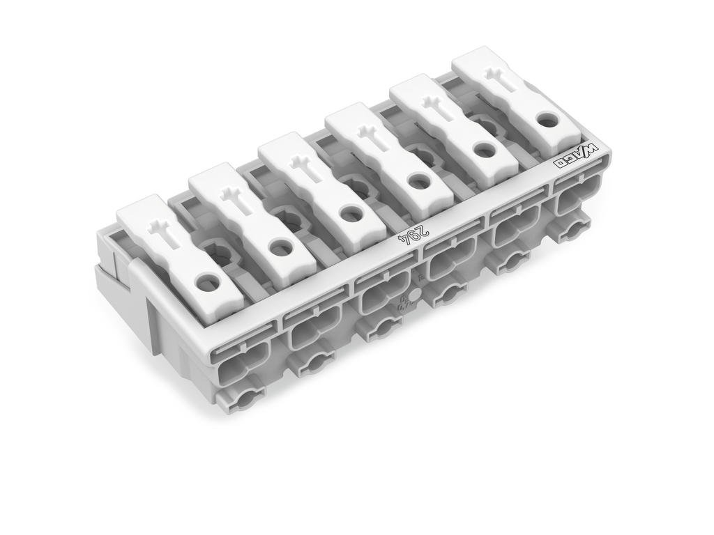

Datasheet Wago 294-4006 — Даташит
Разъем питания; без заземляющего контакта; без защелкивающихся монтажных ножек; простой; 6-контактный
Купить 294-4006 на РадиоЛоцман.Цены — от 113 до 13 580 ₽ , Splice terminal: installation; ways:6; 0.5÷2.5mm²; 24A; 500V | |||
294-4006 Wago | 113 ₽ | ||
294-4006 Wago | 116 ₽ | ||
650.2944.006 Altech | 13 580 ₽ | ||
294-4006 Wago | по запросу |
Actuation type | Operating tool Push-button |
Clamping spring material | Chrome nickel spring steel (CrNi) |
Цвет | white |
Connectable conductor materials | Copper |
Connection technology | Push-in CAGE CLAMP® |
Connection technology 2 | PUSH WIRE® |
Connection type (1) | External 1 |
Connection type (2) | Internal 2 |
Connection type (3) | Internal 3 |
Connection type (4) | Internal 4 |
Contact material | Electrolytic copper (Ecu) |
Contact plating | tin-plated |
Country of origin | CH |
Габариты: глубина | 27.3 mm / 1.075 inch |
Fine-stranded conductor | 0.5 … 2.5 mm² / 18 … 14 AWG |
Fine-stranded conductor with ferrule with plastic collar | 0.5 … 1.5 mm² / 18 … 16 AWG |
Fine-stranded conductor with ferrule without plastic collar | 0.5 … 1.5 mm² / 18 … 16 AWG |
Fine-stranded conductor with ferrule, push-in termination, from | 0.5 mm² / 18 AWG |
Fine-stranded conductor with insulated ferrule (2) | 0.5 … 1 mm² / 18 … 16 AWG |
Fine-stranded conductor with insulated ferrule (3) | 0.5 … 0.75 mm² / 18 AWG |
Fine-stranded conductor with uninsulated ferrule (2) | 0.5 … 1.5 mm² / 18 … 14 AWG |
Fine-stranded conductor with uninsulated ferrule (3) | 0.5 … 1 mm² / 18 AWG |
Fire load | 0.359 MJ |
GTIN | 4050821097631 |
Height from the surface | 17 mm / 0.669 inch |
Insulating material | Polycarbonate (PC) |
Legend (ratings) | (III / 3) ≙ Overvoltage category III / Pollution degree 3 |
Marking | plain |
Material group | III a |
Number of Poles | 6 |
Number of connection points | 1 |
Number of connection points (connection type) | 2 |
Number of connection types | 4 |
Product Group | 8 (Misc. Chassis Mount Blocks) |
Rated current | 24 A |
Rated current (2) | 24 A |
Rated current (3) | 16 A |
Rated impulse voltage (II / 2) | 4 kV |
Rated impulse voltage (II / 2) 2 | 4 kV |
Rated voltage (II / 2) | 500 В |
Rated voltage (II / 2) 2 | 500 В |
Ratings according to 2 | IEC/EN 60998-2-2 |
Ratings note | Connection points |
Ratings note 2 | Connection points |
Solid conductor | 0.5 … 2.5 mm² / 18 … 12 AWG |
Solid conductor (2) | 0.5 … 2.5 mm² / 18 … 14 AWG |
Solid conductor (3) | 0.5 … 1.5 mm² / 18 … 16 AWG |
Solid conductor (4) | 0.5 … 0.75 mm² / 18 AWG |
Solid conductor, push-in termination | 0.5 … 2.5 mm² / 18 … 12 AWG |
Stranded conductor | 0.5 … 2.5 mm² / 18 … 14 AWG |
Strip length | 8 … 9 mm / 0.31 … 0.35 Inch |
Strip length (2) | 8 … 9 mm / 0.31 … 0.35 Inch |
Temperature stability | 120 °C |
Total number of connection points | 30 |
Total number of potentials | 6 |
Type of wiring | Side-entry wiring |
Вес | 18.161 г |
Ширина | 60 mm / 2.362 inch |
