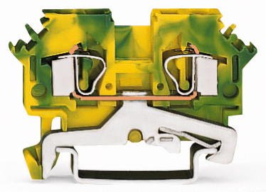

2-проводная клеммная колодка заземления; 4 мм²; подходит для применений Ex e II; боковые пазы для маркеров; для DIN-рейки 35 x 15 и 35 x 7,5; CAGE CLAMP
2-CONDUCTOR GROUND TERMINAL BLOC | |||
| 281-607/999-950 Wago | по запросу | ||
| Actuation type | Operating tool |
| Цвет | green-yellow |
| Connectable conductor materials | Copper |
| Connection technology | CAGE CLAMP® |
| Country of origin | DE |
| Габариты: глубина | 53 mm / 2.087 inch |
| Design | horizontal |
| Fine-stranded conductor | 0.08 … 4 mm² / 28 … 12 AWG |
| Fire load | 0.118 MJ |
| GTIN | 4044918512152 |
| Height from upper-edge of DIN-35 rail | 29 mm / 1.142 inch |
| Insulating material | Polyamide 66 (PA 66) |
| Marking level | Side marking |
| Number of levels | 1 |
| Product Group | 1 (Rail Mounted Terminal Blocks) |
| Solid conductor | 0.08 … 4 mm² / 28 … 12 AWG |
| Strip length | 9 … 10 mm / 0.35 … 0.39 Inch |
| Total number of connection points | 2 |
| Total number of potentials | 1 |
| Type of mounting | DIN-35 rail |
| Type of wiring | Front-entry wiring |
| Вес | 11.78 г |
| Ширина | 6 mm / 0.236 inch |
