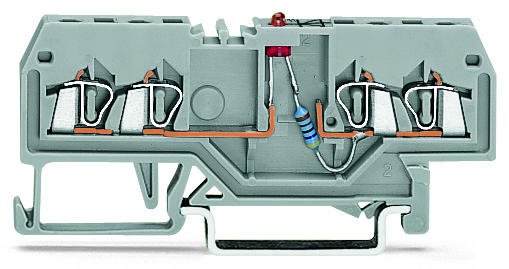

Светодиодная клеммная колодка; с красным светодиодом (NP); 24 В постоянного тока; крепление на рейку; 4-проводная; ширина 4 мм; серая
| COMPONENT TERMINAL BLOCK; 4-COND | |||
| 279-809/281-413 Wago | по запросу | ||
| Actuation type | Operating tool |
| Цвет | gray |
| Connectable conductor materials | Copper |
| Connection technology | CAGE CLAMP® |
| Country of origin | DE |
| Габариты: глубина | 73 mm / 2.874 inch |
| Design | horizontal |
| Fine-stranded conductor | 0.08 … 1.5 mm² / 28 … 16 AWG |
| Fire load | 0.12 MJ |
| GTIN | 4045454194086 |
| Height from upper-edge of DIN-35 rail | 27 mm / 1.063 inch |
| Insulating material | Polyamide 66 (PA 66) |
| Marking level | Center marking |
| Nominal voltage | 24 В |
| Number of levels | 1 |
| Product Group | 1 (Rail Mounted Terminal Blocks) |
| Solid conductor | 0.08 … 1.5 mm² / 28 … 16 AWG |
| Strip length | 8 … 9 mm / 0.31 … 0.35 Inch |
| Total number of connection points | 4 |
| Total number of potentials | 1 |
| Type of mounting | DIN-35 rail |
| Type of wiring | Front-entry wiring |
| Voltage type (1) | DC |
| Вес | 6.587 г |
| Ширина | 4 mm / 0.157 inch |
