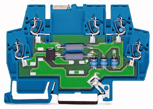

Клеммная колодка; IT MDEX 24; искробезопасные цепи; 24 В постоянного тока
AllElco Electronics
792-803
Wago
10 149 ₽
Augswan
792-803
Wago
Capacity line/PG≤ 6 pF
Capacity line/line≤ 1 nF
Цветblau
Connection technologyCAGE CLAMP®
Connections (number)5
Country of originDE
Габариты: глубина91 mm / 3.583 inch
Fine-stranded conductor0.08 … 2.5 mm² / 28 … 14 AWG
GTIN4017332780766
Height from upper-edge of DIN-35 rail56 mm / 2.205 inch
Impedance1.8 Ω
Limit frequency line/line6 МГц
Max. Input voltage acc. to EN 50020 Ui30 В
Max. input current acc. to EN 50020 Ii0.5 A
Maximum continuous operating voltage23 VAC / 33 VDC
Nominal current0.5 A
Nominal discharge current (8/20 µs) in total10 kA
Nominal discharge current (8/20 µs) per line5 kA
Nominal operating voltage24 VDC
Product Group21 (Special Products Electronic)
Response time line/PG≤ 100 ns
Response time line/line≤ 1 ns
Solid conductor0.08 … 2.5 mm² / 28 … 14 AWG
Standards/specificationsIEC 61643-21
Strip length5 … 6 mm / 0.2 … 0.24 Inch
Surrounding air (operating) temperature-40 … 80 °C
Surrounding air (storage) temperature-40 … 80 °C
Type of mountingDIN-35 rail
Voltage protection level line/PG (cat. C2 at IN)≤ 50 V
Voltage protection level line/PG (cat. C3 at IN)≤ 1.4 kV
Voltage protection level line/line (cat. C2 at IN)≤ 1.5 kV
Voltage protection level line/line (cat. C3 at IN)≤ 45 V
Вес38.3 г
Ширина6 mm / 0.236 inch
