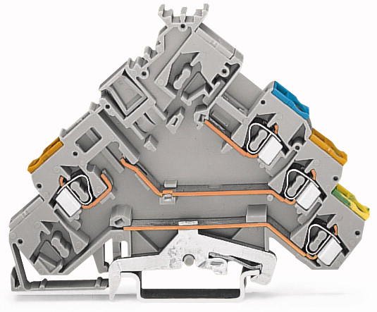

Клеммная колодка привода с 2 проводниками; с заземляющим контактом; с цветными вводами проводников; 2,5 мм²; CAGE CLAMP

Actuation type | Operating tool |
Цвет | gray |
Connectable conductor materials | Copper |
Connection technology | CAGE CLAMP® |
Country of origin | DE |
Габариты: глубина | 90.5 mm / 3.563 inch |
Design | angled |
Fine-stranded conductor | 0.08 … 2.5 mm² / 28 … 12 AWG |
Fire load | 0.232 MJ |
GTIN | 4045454093761 |
Height from upper-edge of DIN-35 rail | 63.5 mm / 2.5 inch |
Legend (ratings) | (III / 3) ≙ Overvoltage category III / Pollution degree 3 |
Marking level | Center marking |
Number of levels | 4 |
Product Group | 1 (Rail Mounted Terminal Blocks) |
Rated current | 5 A |
Rated current (2) | 6.3 A |
Rated voltage (III / 3) | 125 В |
Rated voltage (III / 3) 2 | 250 В |
Solid conductor | 0.08 … 2.5 mm² / 28 … 12 AWG |
Strip length | 8 … 9 mm / 0.31 … 0.35 Inch |
Total number of connection points | 4 |
Total number of potentials | 4 |
Type of mounting | DIN-35 rail |
Type of wiring | Front-entry wiring |
Вес | 17.464 г |
Ширина | 5 mm / 0.197 inch |
