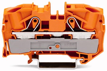

Клеммная колодка TOPJOB S проходная; монтаж на рейку; 2-проводная; ширина 12 мм; оранжевый

Actuation type | Open Tool Slot |
Цвет | orange |
Connectable conductor materials | Copper |
Connection technology | Push-in CAGE CLAMP® |
Country of origin | DE |
Габариты: глубина | 69.8 mm / 2.748 inch |
Design | horizontal |
Fine-stranded conductor | 0.5 … 25 mm² / 20 … 4 AWG |
Fine-stranded conductor with ferrule, push-in termination, from | 6 mm² / 14 AWG |
Fire load | 0.464 MJ |
GTIN | 4017332076555 |
Height from upper-edge of DIN-35 rail | 36.9 mm / 1.453 inch |
Marking level | Center/side marking |
Nominal cross section | 16 mm² |
Number of levels | 1 |
Product Group | 22 (TOPJOB S) |
Rated current (Ex e II) | 70 A |
Rated current (Ex e II) with jumper | 67 A |
Rated voltage EN (Ex e II) | 550 В |
Solid conductor | 0.5 … 16 mm² / 20 … 6 AWG |
Solid conductor, push-in termination | 6 … 16 mm² / 14 … 6 AWG |
Strip length | 18 … 20 mm / 0.71 … 0.79 Inch |
Total number of connection points | 2 |
Total number of potentials | 1 |
Type of mounting | DIN-35 rail |
Type of wiring | Front-entry wiring |
Вес | 21.7 г |
Ширина | 12 mm / 0.472 inch |
