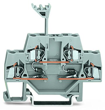

Двухъярусная диодная клеммная колодка; с 2 диодами 1N4007
COMPONENT TERMINAL BLOCK; DOUBLE | |||
| 280-941/281-489 Wago | по запросу | ||
| 280-941/281-489 Switchcraft | по запросу | ||
| Actuation type | Operating tool |
| Цвет | gray |
| Connectable conductor materials | Copper |
| Connection technology | CAGE CLAMP® |
| Country of origin | DE |
| Габариты: глубина | 64 mm / 2.52 inch |
| Design | horizontal |
| Fine-stranded conductor | 0.08 … 2.5 mm² / 28 … 14 AWG |
| Fire load | 0.188 MJ |
| GTIN | 4045454196684 |
| Height from upper-edge of DIN-35 rail | 58.5 mm / 2.303 inch |
| Insulating material | Polyamide 66 (PA 66) |
| Marking level | Center marking |
| Nominal voltage | 250 В |
| Number of levels | 2 |
| Product Group | 1 (Rail Mounted Terminal Blocks) |
| Reverse voltage | 1000 В |
| Solid conductor | 0.08 … 2.5 mm² / 28 … 14 AWG |
| Strip length | 8 … 9 mm / 0.31 … 0.35 Inch |
| Total number of connection points | 4 |
| Total number of potentials | 2 |
| Type of mounting | DIN-35 rail |
| Type of wiring | Front-entry wiring |
| Вес | 10.27 г |
| Ширина | 5 mm / 0.197 inch |
