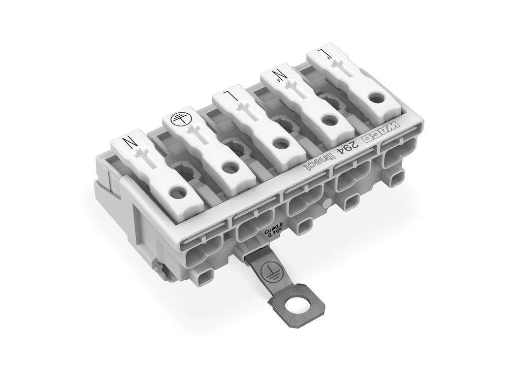

Datasheet Wago 294-8415 — Даташит
Разъем питания; версия 17 мм; с винтовым заземляющим контактом; L3-L2-L1-PE-N; 5-полюсный
Actuation type | Push-button |
Actuation type 2 | Push-in |
Actuation type 3 | Push-in |
Actuation type 4 | Push-in |
Clamping spring material | Chrome nickel spring steel (CrNi) |
Цвет | white |
Connection technology | Push-in CAGE CLAMP® |
Connection technology 2 | PUSH WIRE® |
Connection technology 3 | PUSH WIRE® |
Connection technology 4 | PUSH WIRE® |
Connection type (1) | External 1 |
Connection type (2) | Internal 2 |
Connection type (3) | Internal 3 |
Connection type (4) | Internal 4 |
Contact material | Electrolytic copper (Ecu) |
Contact plating | tin-plated |
Country of origin | PL |
Габариты: глубина | 27.3 mm / 1.075 inch |
Fine-stranded conductor | 0.5 … 2.5 mm² / 18 … 14 AWG |
Fine-stranded conductor with ferrule with plastic collar | 0.5 … 1.5 mm² / 18 … 16 AWG |
Fine-stranded conductor with ferrule without plastic collar | 0.5 … 1.5 mm² / 18 … 16 AWG |
Fine-stranded conductor with ferrule, push-in termination, from | 0.5 mm² / 18 AWG |
Fine-stranded conductor with insulated ferrule (2) | 0.5 … 1 mm² / 18 … 14 AWG |
Fine-stranded conductor with insulated ferrule (3) | 0.5 … 0.75 mm² / 18 AWG |
Fine-stranded conductor with uninsulated ferrule (2) | 0.5 … 1.5 mm² / 18 … 16 AWG |
Fine-stranded conductor with uninsulated ferrule (3) | 0.5 … 1 mm² / 18 … 14 AWG |
Fire load | 0.33 MJ |
GTIN | 4050821487081 |
Ground function | with screw-type GND contact |
Height | 22.4 mm / 0.882 inch |
Height from the surface | 17 mm / 0.669 inch |
Insulating material | Polycarbonate (PC) |
Legend (ratings) | (III / 2) ≙ Overvoltage category III / Pollution degree 2 |
Marking | L3 L2 L1 ⏚ N |
Material group | III a |
Number of Poles | 5 |
Number of connection points | 1 |
Number of connection points (connection type) | 2 |
Number of connection types | 4 |
Packaging type | bag |
Product Group | 8 (Misc. Chassis Mount Blocks) |
Rated current | 24 A |
Rated current (2) | 24 A |
Rated current (3) | 16 A |
Rated impulse voltage (II / 2) | 4 kV |
Rated impulse voltage (II / 2) 2 | 4 kV |
Rated impulse voltage (II / 2) 3 | 4 kV |
Rated voltage (II / 2) | 500 В |
Rated voltage (II / 2) 2 | 500 В |
Rated voltage (II / 2) 3 | 500 В |
Ratings Note 3 | Linect® plug-in connection |
Ratings according to 2 | IEC/EN 60998-2-2 |
Ratings according to 3 | IEC/EN 61984 |
Ratings note | Connection points |
Ratings note 2 | Connection points |
Solid conductor | 0.5 … 2.5 mm² / 18 … 12 AWG |
Solid conductor (2) | 0.5 … 2.5 mm² / 18 … 14 AWG |
Solid conductor (3) | 0.5 … 1.5 mm² / 18 … 16 AWG |
Solid conductor (4) | 0.5 … 0.75 mm² / 18 AWG |
Solid conductor, push-in termination | 0.5 … 2.5 mm² / 18 … 12 AWG |
Stranded conductor | 0.5 … 2.5 mm² / 18 … 14 AWG |
Strip length | 8 … 9 mm / 0.31 … 0.35 Inch |
Strip length (2) | 8 … 9 mm / 0.31 … 0.35 Inch |
Strip length (3) | 8 … 9 mm / 0.31 … 0.35 Inch |
Strip length (4) | 8 … 9 mm / 0.31 … 0.35 Inch |
Temperature stability | 120 °C |
Total number of potentials | 5 |
Вес | 16.75 г |
Ширина | 50 mm / 1.969 inch |
