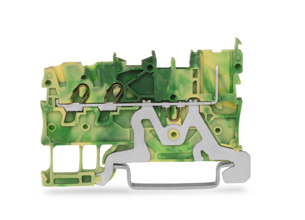

Datasheet Wago 2020-1307 — Даташит
X-COM S-Mini заземляющий/проходной клеммный блок; монтаж на рейку; 2-проводной, 1-контактный; ширина 3,5 мм; желто-зеленый
Купить 2020-1307 на РадиоЛоцман.Цены — от 740 до 2 475 ₽6 предложений от 3 поставщиков 2-CONDUCTOR/1-PIN GROUND CARRIER | |||
| 2020-1307 Wago | от 740 ₽ | ||
| 2020-1307 Wago | 2 475 ₽ | ||
| 2020-1307 Wago | по запросу | ||
| Actuation type | Open Tool Slot |
| Цвет | green-yellow |
| Connectable conductor materials | Copper |
| Connection technology | Push-in CAGE CLAMP® |
| Country of origin | DE |
| Габариты: глубина | 60.5 mm / 2.382 inch |
| Design | horizontal |
| Fine-stranded conductor | 0.14 … 1.5 mm² / 24 … 16 AWG |
| Fine-stranded conductor with ferrule, push-in termination, from | 0.5 mm² / 20 AWG |
| GTIN | 4055143288118 |
| Height from upper-edge of DIN-35 rail | 32.5 mm / 1.28 inch |
| Insulating material | Polyamide 66 (PA 66) |
| Marking level | Center/side marking |
| Nominal cross section | 1 mm² |
| Number of connection points | 1 |
| Number of connection points (connection type) | 2 |
| Number of levels | 1 |
| Packaging type | BOX |
| Solid conductor | 0.14 … 1.5 mm² / 24 … 16 AWG |
| Solid conductor, push-in termination | 0.5 … 1.5 mm² / 20 … 16 AWG |
| Strip length | 9 … 11 mm / 0.35 … 0.43 Inch |
| Total number of connection points | 2 |
| Total number of potentials | 1 |
| Type of mounting | DIN-35 rail |
| Type of wiring | Front-entry wiring |
| Вес | 6.57 г |
| Ширина | 3.5 mm / 0.138 inch |
