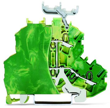

Двухуровневая клеммная колодка заземления TOPJOB S; с внутренним объединением; с серым разделителем; с держателем маркера; монтаж на рейку; 4-проводная; ширина 6,2 мм; желто-зеленая
DOUBLE-DECK TERMINAL BLOCK; 4-CO | |||
2002-2237/099-000 Wago | по запросу |
Actuation type | Open Tool Slot |
Цвет | green-yellow |
Connectable conductor materials | Copper |
Connection technology | Push-in CAGE CLAMP® |
Country of origin | DE |
Габариты: глубина | 69.7 mm / 2.744 inch |
Design | horizontal |
Fine-stranded conductor | 0.25 … 4 mm² / 22 … 12 AWG |
Fine-stranded conductor with ferrule, push-in termination, from | 0.75 mm² / 18 AWG |
Fire load | 0.311 MJ |
GTIN | 4050821299110 |
Height from upper-edge of DIN-35 rail | 61.8 mm / 2.433 inch |
Marking level | Center/side marking |
Nominal cross section | 2.5 mm² |
Number of levels | 2 |
Potential marking | PE |
Solid conductor | 0.25 … 4 mm² / 22 … 12 AWG |
Solid conductor, push-in termination | 0.75 … 4 mm² / 18 … 12 AWG |
Strip length | 10 … 12 mm / 0.39 … 0.47 Inch |
Total number of connection points | 4 |
Total number of potentials | 1 |
Type of mounting | DIN-35 rail |
Type of wiring | Front-entry wiring |
Вес | 17.003 г |
Ширина | 6.2 mm / 0.244 inch |
