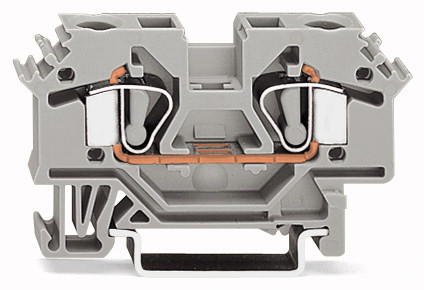

2-проводная проходная клеммная колодка; 6 мм²; подходит для применений Ex e II; боковые маркерные пазы; для DIN-рейки 35 x 15 и 35 x 7,5; CAGE CLAMP
2-CONDUCTOR THROUGH TERMINAL BLO | |||
282691-000 TE Connectivity | 14 ₽ | ||
282-691 Wago | по запросу |
Actuation type | Operating tool |
Цвет | light gray |
Connectable conductor materials | Copper |
Connection technology | CAGE CLAMP® |
Country of origin | DE |
Габариты: глубина | 62 mm / 2.441 inch |
Design | horizontal |
Fine-stranded conductor | 0.2 … 6 mm² / 24 … 10 AWG |
Fire load | 0.207 MJ |
GTIN | 4044918306898 |
Height from upper-edge of DIN-35 rail | 31.5 mm / 1.24 inch |
Marking level | Side marking |
Number of levels | 1 |
Product Group | 1 (Rail Mounted Terminal Blocks) |
Rated voltage EN (Ex e II) | 550 В |
Solid conductor | 0.2 … 6 mm² / 24 … 10 AWG |
Strip length | 12 … 13 mm / 0.47 … 0.51 Inch |
Total number of connection points | 2 |
Total number of potentials | 1 |
Type of mounting | DIN-35 rail |
Type of wiring | Front-entry wiring |
Вес | 12.622 г |
Ширина | 8 mm / 0.315 inch |
