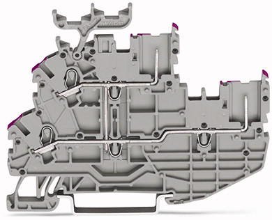

2-проводные / 2-контактные двухуровневые базовые клеммы; 2-проводные / 2-контактные проходные клеммы; L:; внутреннее объединение; ввод проводника с фиолетовой маркировкой; для DIN-рейки 35 x 15 и 35 x 7,5; Push-in CAGE CLAMP
2-CONDUCTOR/2-PIN, DOUBLE-DECK C | |||
| 2020-2208 Wago | по запросу | ||
| Actuation type | Open Tool Slot |
| Цвет | gray |
| Connectable conductor materials | Copper |
| Connection technology | Push-in CAGE CLAMP® |
| Country of origin | DE |
| Габариты: глубина | 80.1 mm / 3.154 inch |
| Design | horizontal |
| Fine-stranded conductor | 0.14 … 1.5 mm² / 24 … 16 AWG |
| Fine-stranded conductor with ferrule, push-in termination, from | 0.5 mm² / 20 AWG |
| Fire load | 0.191 MJ |
| GTIN | 4050821049531 |
| Height from upper-edge of DIN-35 rail | 51.3 mm / 2.02 inch |
| Insulating material | Polyamide 66 (PA 66) |
| Legend (ratings) | (III / 3) ≙ Overvoltage category III / Pollution degree 3 |
| Marking level | Side marking |
| Nominal cross section | 1 mm² |
| Number of levels | 2 |
| Potential marking | L |
| Product Group | 18 (X-COM-System) |
| Rated current | 13.5 A |
| Rated impulse voltage (III / 3) | 6 kV |
| Rated voltage (III / 3) | 500 В |
| Solid conductor | 0.14 … 1.5 mm² / 24 … 16 AWG |
| Solid conductor, push-in termination | 0.5 … 1.5 mm² / 20 … 16 AWG |
| Strip length | 9 … 11 mm / 0.35 … 0.43 Inch |
| Total number of connection points | 2 |
| Total number of potentials | 1 |
| Type of mounting | DIN-35 rail |
| Type of wiring | Front-entry wiring |
| Вес | 9.98 г |
| Ширина | 3.5 mm / 0.138 inch |
