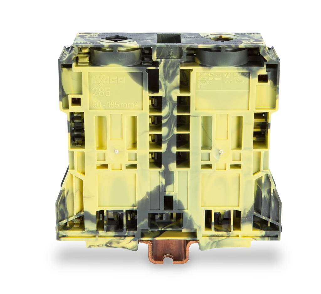

2-проводная проходная клеммная колодка; 185 мм²; боковые пазы для маркеров; только для рейки DIN 35 x 15; толщина 2,3 мм; медь; POWER CAGE CLAMP
Augswan
285-1181
Wago
Actuation typeOperating tool
Цветdark gray-yellow
Connectable conductor materialsCopper
Connection technologyPOWER CAGE CLAMP
Country of originDE
Габариты: глубина133 mm / 5.236 inch
Designhorizontal
Fine-stranded conductor50 … 185 mm² / 1/0 AWG … 350 kcmil
Fine-stranded conductor with ferrule with plastic collar50 … 150 mm² / 1/0 AWG … 300 kcmil
Fine-stranded conductor with ferrule without plastic collar50 … 185 mm² / 1/0 AWG … 350 kcmil
Fire load0.408 MJ
GTIN4055143418508
Height from upper-edge of DIN-35 rail116 mm / 4.567 inch
Insulating materialPolyamide 66 (PA 66)
Legend (ratings)(III / 3) ≙ Overvoltage category III / Pollution degree 3
Marking levelSide marking
Nominal cross section185 mm²
Number of levels1
Rated current353 A
Rated impulse voltage (III / 3)12 kV
Rated impulse voltage (III / 3) 212 kV
Rated voltage (III / 3)1000 В
Rated voltage (III / 3) 21500 В
Solid conductor50 … 185 mm² / 1/0 AWG … 350 kcmil
Stranded conductor50 … 185 mm² / 1/0 AWG … 350 kcmil
Strip length45 … 47 mm / 1.77 … 1.85 Inch
Total number of connection points2
Total number of potentials1
Type of mountingDIN-35 rail
Type of wiringSide-entry wiring
Вес534.9 г
Ширина32 mm / 1.26 inch
