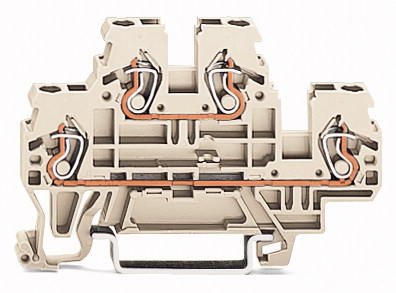

Двухуровневый клеммный блок; Сквозной/сквозной клеммный блок; L/L; подходит для применений Ex e II; для DIN-рейки 35 x 15 и 35 x 7,5; 2,5 мм²; CAGE CLAMP
DOUBLE-DECK TERMINAL BLOCK; THRO | |||
| 870-961 Wago | по запросу | ||
| Actuation type | Operating tool |
| Цвет | light gray |
| Connectable conductor materials | Copper |
| Connection technology | CAGE CLAMP® |
| Country of origin | DE |
| Габариты: глубина | 70 mm / 2.756 inch |
| Design | horizontal |
| Fine-stranded conductor | 0.08 … 4 mm² / 28 … 12 AWG |
| Fire load | 0.168 MJ |
| GTIN | 4044918852401 |
| Height from upper-edge of DIN-35 rail | 40 mm / 1.575 inch |
| Marking level | Side marking |
| Number of levels | 2 |
| Potential marking | L/L |
| Product Group | 16 (Rail Mounted Terminal Block with CCC) |
| Rated voltage EN (Ex e II) | 420 В |
| Solid conductor | 0.08 … 2.5 mm² / 28 … 12 AWG |
| Strip length | 6 … 7 mm / 0.24 … 0.28 Inch |
| Total number of connection points | 4 |
| Total number of potentials | 2 |
| Type of mounting | DIN-35 rail |
| Type of wiring | Front-entry wiring |
| Вес | 9.943 г |
| Ширина | 5 mm / 0.197 inch |
