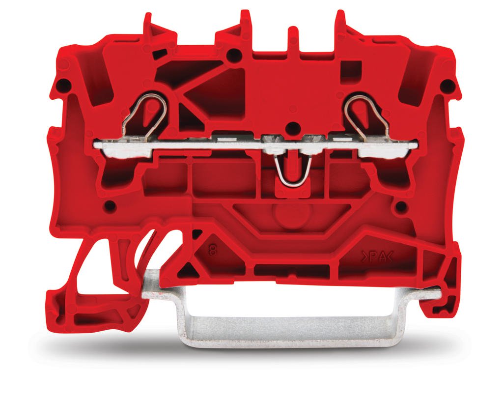

Parameters / Models | 2001-115![]() | 2001-1201![]() | 2001-1202![]() | 2001-1203![]() | 2001-1204![]() | 2001-1205![]() | 2001-1206![]() | 2001-1207![]() | 2001-1208![]() | 2001-1211/1000-410![]() | 2001-1211/1000-411![]() | 2001-1301![]() | 2001-1302![]() | 2001-1303![]() | 2001-1304![]() | 2001-1305![]() | 2001-1306![]() | 2001-1307![]() | 2001-1308![]() | 2001-1311/1000-410![]() | 2001-1311/1000-411![]() | 2001-1321/1000-413![]() | 2001-1321/1000-434![]() | 2001-1401![]() | 2001-1402![]() | 2001-1403![]() | 2001-1404![]() | 2001-1405![]() | 2001-1406![]() | 2001-1407![]() | 2001-1408![]() | 2001-1411/1000-410![]() | 2001-1411/1000-411![]() | 2001-1421/1000-413![]() | 2001-1421/1000-434![]() | 2001-1441![]() | 2001-171![]() | 2001-402![]() | 2001-403![]() | 2001-404![]() | 2001-405![]() | 2001-405/011-000![]() | 2001-406![]() | 2001-406/020-000![]() | 2001-407![]() | 2001-408![]() | 2001-409![]() | 2001-410![]() | 2001-433![]() | 2001-434![]() | 2001-435![]() | 2001-436![]() | 2001-437![]() | 2001-438![]() | 2001-439![]() | 2001-440![]() | 2001-511![]() | 2001-549![]() | 2001-552![]() | 2001-553![]() | 2001-554![]() | 2001-555![]() | 2001-556![]() | 2001-557![]() | 2001-558![]() | 2001-559![]() | 2001-560![]() |
Actuation type | Open Tool Slot | Open Tool Slot | Open Tool Slot | Open Tool Slot | Open Tool Slot | Open Tool Slot | Open Tool Slot | Open Tool Slot | Open Tool Slot | Open Tool Slot | Open Tool Slot | Open Tool Slot | Open Tool Slot | Open Tool Slot | Open Tool Slot | Open Tool Slot | Open Tool Slot | Open Tool Slot | Open Tool Slot | Open Tool Slot | Open Tool Slot | Open Tool Slot | Open Tool Slot | Open Tool Slot | Open Tool Slot | Open Tool Slot | Open Tool Slot | Open Tool Slot | Open Tool Slot | Open Tool Slot | Open Tool Slot | Open Tool Slot | Open Tool Slot | Open Tool Slot | Open Tool Slot | Open Tool Slot | Open Tool Slot | Open Tool Slot | Open Tool Slot | Open Tool Slot | Open Tool Slot | Open Tool Slot | Open Tool Slot | Open Tool Slot | |||||||||||||||||||||||
Цвет | yellow | gray | orange | red | blue | black | yellow | green-yellow | white | gray | gray | gray | orange | red | blue | black | yellow | green-yellow | white | gray | gray | gray | gray | gray | orange | red | blue | black | yellow | green-yellow | white | gray | gray | gray | gray | gray | light gray | light gray | light gray | light gray | light gray | light gray | light gray | light gray | light gray | light gray | light gray | light gray | light gray | light gray | light gray | light gray | light gray | light gray | light gray | light gray | gray | gray | gray | gray | gray | gray | gray | gray | gray | gray | gray |
Connectable conductor materials | Copper | Copper | Copper | Copper | Copper | Copper | Copper | Copper | Copper | Copper | Copper | Copper | Copper | Copper | Copper | Copper | Copper | Copper | Copper | Copper | Copper | Copper | Copper | Copper | Copper | Copper | Copper | Copper | Copper | Copper | Copper | Copper | Copper | Copper | Copper | ||||||||||||||||||||||||||||||||
Connection technology | Push-in CAGE CLAMP® | Push-in CAGE CLAMP® | Push-in CAGE CLAMP® | Push-in CAGE CLAMP® | Push-in CAGE CLAMP® | Push-in CAGE CLAMP® | Push-in CAGE CLAMP® | Push-in CAGE CLAMP® | Push-in CAGE CLAMP® | Push-in CAGE CLAMP® | Push-in CAGE CLAMP® | Push-in CAGE CLAMP® | Push-in CAGE CLAMP® | Push-in CAGE CLAMP® | Push-in CAGE CLAMP® | Push-in CAGE CLAMP® | Push-in CAGE CLAMP® | Push-in CAGE CLAMP® | Push-in CAGE CLAMP® | Push-in CAGE CLAMP® | Push-in CAGE CLAMP® | Push-in CAGE CLAMP® | Push-in CAGE CLAMP® | Push-in CAGE CLAMP® | Push-in CAGE CLAMP® | Push-in CAGE CLAMP® | Push-in CAGE CLAMP® | Push-in CAGE CLAMP® | Push-in CAGE CLAMP® | Push-in CAGE CLAMP® | Push-in CAGE CLAMP® | Push-in CAGE CLAMP® | Push-in CAGE CLAMP® | Push-in CAGE CLAMP® | Push-in CAGE CLAMP® | Push-in CAGE CLAMP® | Push-in CAGE CLAMP® | Push-in CAGE CLAMP® | Push-in CAGE CLAMP® | Push-in CAGE CLAMP® | Push-in CAGE CLAMP® | Push-in CAGE CLAMP® | Push-in CAGE CLAMP® | Push-in CAGE CLAMP® | Push-in CAGE CLAMP® | ||||||||||||||||||||||
Country of origin | DE | DE | DE | DE | DE | DE | DE | DE | DE | CN | CN | DE | DE | DE | DE | DE | DE | DE | DE | CN | CN | DE | DE | DE | DE | DE | DE | DE | DE | DE | DE | CN | CN | DE | DE | CN | DE | DE | DE | DE | DE | DE | DE | DE | DE | DE | DE | DE | DE | DE | DE | DE | DE | DE | DE | DE | DE | DE | DE | DE | DE | DE | DE | DE | DE | DE | DE |
Габариты: глубина | 48.5 mm / 1.909 inch | 48.5 mm / 1.909 inch | 48.5 mm / 1.909 inch | 48.5 mm / 1.909 inch | 48.5 mm / 1.909 inch | 48.5 mm / 1.909 inch | 50.8 mm / 2 inch | 50.8 mm / 2 inch | 48.5 mm / 1.909 inch | 48.5 mm / 1.909 inch | 59.2 mm / 2.33 inch | 59.2 mm / 2.33 inch | 59.2 mm / 2.33 inch | 59.2 mm / 2.33 inch | 59.2 mm / 2.33 inch | 59.2 mm / 2.33 inch | 59.2 mm / 2.33 inch | 59.2 mm / 2.33 inch | 59.2 mm / 2.33 inch | 59.2 mm / 2.33 inch | 59.2 mm / 2.33 inch | 59.2 mm / 2.33 inch | 69.9 mm / 2.752 inch | 69.9 mm / 2.752 inch | 69.9 mm / 2.752 inch | 69.9 mm / 2.752 inch | 69.9 mm / 2.752 inch | 69.9 mm / 2.752 inch | 69.9 mm / 2.752 inch | 69.9 mm / 2.752 inch | 69.9 mm / 2.752 inch | 69.9 mm / 2.752 inch | 69.9 mm / 2.752 inch | 69.9 mm / 2.752 inch | 69.9 mm / 2.752 inch | 4.1 mm / 0.161 inch | 4.1 mm / 0.161 inch | 4.1 mm / 0.161 inch | 4.1 mm / 0.161 inch | 4.1 mm / 0.161 inch | 4.1 mm / 0.161 inch | 4.1 mm / 0.161 inch | 4.1 mm / 0.161 inch | 4.1 mm / 0.161 inch | 4.1 mm / 0.161 inch | 4.1 mm / 0.161 inch | 4.1 mm / 0.161 inch | 4.1 mm / 0.161 inch | 4.1 mm / 0.161 inch | 4.1 mm / 0.161 inch | 4.1 mm / 0.161 inch | 4.1 mm / 0.161 inch | 4.1 mm / 0.161 inch | 4.1 mm / 0.161 inch | |||||||||||||
Design | horizontal | horizontal | horizontal | horizontal | horizontal | horizontal | horizontal | horizontal | horizontal | horizontal | horizontal | horizontal | horizontal | horizontal | horizontal | horizontal | horizontal | horizontal | horizontal | horizontal | horizontal | horizontal | horizontal | horizontal | horizontal | horizontal | horizontal | horizontal | horizontal | horizontal | horizontal | horizontal | horizontal | horizontal | horizontal | ||||||||||||||||||||||||||||||||
Fine-stranded conductor | 0.25 … 2.5 mm² / 22 … 14 AWG | 0.25 … 2.5 mm² / 22 … 14 AWG | 0.25 … 2.5 mm² / 22 … 14 AWG | 0.25 … 2.5 mm² / 22 … 14 AWG | 0.25 … 2.5 mm² / 22 … 14 AWG | 0.25 … 2.5 mm² / 22 … 14 AWG | 0.25 … 2.5 mm² / 22 … 14 AWG | 0.25 … 2.5 mm² / 22 … 14 AWG | 0.25 … 2.5 mm² / 22 … 14 AWG | 0.25 … 2.5 mm² / 22 … 14 AWG | 0.25 … 2.5 mm² / 22 … 14 AWG | 0.25 … 2.5 mm² / 22 … 14 AWG | 0.25 … 2.5 mm² / 22 … 14 AWG | 0.25 … 2.5 mm² / 22 … 14 AWG | 0.25 … 2.5 mm² / 22 … 14 AWG | 0.25 … 2.5 mm² / 22 … 14 AWG | 0.25 … 2.5 mm² / 22 … 14 AWG | 0.25 … 2.5 mm² / 22 … 14 AWG | 0.25 … 2.5 mm² / 22 … 14 AWG | 0.25 … 2.5 mm² / 22 … 14 AWG | 0.25 … 2.5 mm² / 22 … 14 AWG | 0.25 … 2.5 mm² / 22 … 14 AWG | 0.25 … 2.5 mm² / 22 … 14 AWG | 0.25 … 2.5 mm² / 22 … 14 AWG | 0.25 … 2.5 mm² / 22 … 14 AWG | 0.25 … 2.5 mm² / 22 … 14 AWG | 0.25 … 2.5 mm² / 22 … 14 AWG | 0.25 … 2.5 mm² / 22 … 14 AWG | 0.25 … 2.5 mm² / 22 … 14 AWG | 0.25 … 2.5 mm² / 22 … 14 AWG | 0.25 … 2.5 mm² / 22 … 14 AWG | 0.25 … 2.5 mm² / 22 … 14 AWG | 0.25 … 2.5 mm² / 22 … 14 AWG | 0.25 … 2.5 mm² / 22 … 14 AWG | 0.25 … 2.5 mm² / 22 … 14 AWG | 0.25 … 2.5 mm² / 22 … 14 AWG | 0.25 … 2.5 mm² / 22 … 14 AWG | 0.25 … 2.5 mm² / 22 … 14 AWG | 0.25 … 2.5 mm² / 22 … 14 AWG | 0.25 … 2.5 mm² / 22 … 14 AWG | 0.25 … 2.5 mm² / 22 … 14 AWG | 0.25 … 2.5 mm² / 22 … 14 AWG | 0.25 … 2.5 mm² / 22 … 14 AWG | 0.25 … 2.5 mm² / 22 … 14 AWG | 0.25 … 2.5 mm² / 22 … 14 AWG | ||||||||||||||||||||||
Fine-stranded conductor with ferrule, push-in termination, from | 0.75 mm² / 18 AWG | 0.75 mm² / 18 AWG | 0.75 mm² / 18 AWG | 0.75 mm² / 18 AWG | 0.75 mm² / 18 AWG | 0.75 mm² / 18 AWG | 0.75 mm² / 18 AWG | 0.75 mm² / 18 AWG | 0.75 mm² / 18 AWG | 0.75 mm² / 18 AWG | 0.75 mm² / 18 AWG | 0.75 mm² / 18 AWG | 0.75 mm² / 18 AWG | 0.75 mm² / 18 AWG | 0.75 mm² / 18 AWG | 0.75 mm² / 18 AWG | 0.75 mm² / 18 AWG | 0.75 mm² / 18 AWG | 0.75 mm² / 18 AWG | 0.75 mm² / 18 AWG | 0.75 mm² / 18 AWG | 0.75 mm² / 18 AWG | 0.75 mm² / 18 AWG | 0.75 mm² / 18 AWG | 0.75 mm² / 18 AWG | 0.75 mm² / 18 AWG | 0.75 mm² / 18 AWG | 0.75 mm² / 18 AWG | 0.75 mm² / 18 AWG | 0.75 mm² / 18 AWG | 0.75 mm² / 18 AWG | 0.75 mm² / 18 AWG | 0.75 mm² / 18 AWG | 0.75 mm² / 18 AWG | 0.75 mm² / 18 AWG | 0.75 mm² / 18 AWG | 0.75 mm² / 18 AWG | 0.75 mm² / 18 AWG | 0.75 mm² / 18 AWG | 0.75 mm² / 18 AWG | 0.75 mm² / 18 AWG | 0.75 mm² / 18 AWG | 0.75 mm² / 18 AWG | 0.75 mm² / 18 AWG | 0.75 mm² / 18 AWG | ||||||||||||||||||||||
Fire load, MJ | 0.005 | 0.086 | 0.074 | 0.074 | 0.074 | 0.074 | 0.074 | 0.074 | 0.072 | 0.094 | 0.094 | 0.093 | 0.092 | 0.093 | 0.093 | 0.106 | 0.093 | 0.089 | 0.109 | 0.109 | 0.103 | 0.104 | 0.104 | 0.104 | 0.104 | 0.104 | 0.104 | 0.102 | 0.102 | 0.148 | 0.148 | 0.138 | 0.138 | 0.138 | 0.017 | 0.006 | 0.009 | 0.012 | 0.015 | 0.015 | 0.018 | 0.018 | 0.021 | 0.024 | 0.027 | 0.03 | 0.007 | 0.009 | 0.011 | 0.013 | 0.015 | 0.016 | 0.018 | 0.02 | 0.07 | 0.032 | 0.14 | 0.21 | 0.28 | 0.35 | 0.42 | 0.49 | 0.56 | 0.63 | 0.7 | ||
GTIN | 4045454824204 | 4017332997287 | 4017332997300 | 4045454537364 | 4017332997294 | 4045454537371 | 4045454537388 | 4017332997317 | 4055143448208 | 4045454537548 | 4045454537555 | 4017332998628 | 4017332998642 | 4045454397487 | 4017332998635 | 4045454537395 | 4045454537401 | 4017332998659 | 4055143448222 | 4045454537562 | 4045454537579 | 4045454537593 | 4045454537586 | 4017332998666 | 4017332998680 | 4045454537418 | 4017332998673 | 4045454537425 | 4045454537432 | 4017332998697 | 4045454719487 | 4045454537609 | 4045454537616 | 4045454537630 | 4045454537623 | 4055143274128 | 4044918753494 | 4055143698412 | 4055143698436 | 4055143698450 | 4055143698474 | 4045454924676 | 4017332998819 | 4045454945633 | 4017332998826 | 4055143699334 | 4017332998840 | 4055143699440 | 4055143699488 | 4055143699518 | 4055143699600 | 4017332998895 | 4055143699662 | 4017332998925 | 4017332998949 | 4017332998963 | 4044918975148 | 4017332999083 | 4045454178246 | 4045454178253 | 4045454178260 | 4045454178277 | 4045454178284 | 4045454178291 | 4045454178307 | 4045454178314 | 4045454178321 |
Height | 19 mm / 0.748 inch | 19 mm / 0.748 inch | 19 mm / 0.748 inch | 19 mm / 0.748 inch | 19 mm / 0.748 inch | 19 mm / 0.748 inch | 19 mm / 0.748 inch | 19 mm / 0.748 inch | 19 mm / 0.748 inch | 19 mm / 0.748 inch | 19 mm / 0.748 inch | 19 mm / 0.748 inch | 19 mm / 0.748 inch | 19 mm / 0.748 inch | 19 mm / 0.748 inch | 19 mm / 0.748 inch | 19 mm / 0.748 inch | 19 mm / 0.748 inch | 19 mm / 0.748 inch | ||||||||||||||||||||||||||||||||||||||||||||||||
Height from upper-edge of DIN-35 rail | 32.9 mm / 1.295 inch | 32.9 mm / 1.295 inch | 32.9 mm / 1.295 inch | 32.9 mm / 1.295 inch | 32.9 mm / 1.295 inch | 32.9 mm / 1.295 inch | 32.9 mm / 1.295 inch | 32.9 mm / 1.295 inch | 32.9 mm / 1.295 inch | 32.9 mm / 1.295 inch | 32.9 mm / 1.295 inch | 32.9 mm / 1.295 inch | 32.9 mm / 1.295 inch | 32.9 mm / 1.295 inch | 32.9 mm / 1.295 inch | 32.9 mm / 1.295 inch | 32.9 mm / 1.295 inch | 32.9 mm / 1.295 inch | 32.9 mm / 1.295 inch | 32.9 mm / 1.295 inch | 32.9 mm / 1.295 inch | 32.9 mm / 1.295 inch | 32.9 mm / 1.295 inch | 32.9 mm / 1.295 inch | 32.9 mm / 1.295 inch | 32.9 mm / 1.295 inch | 32.9 mm / 1.295 inch | 32.9 mm / 1.295 inch | 32.9 mm / 1.295 inch | 32.9 mm / 1.295 inch | 32.9 mm / 1.295 inch | 32.9 mm / 1.295 inch | 32.9 mm / 1.295 inch | 32.9 mm / 1.295 inch | 32.9 mm / 1.295 inch | ||||||||||||||||||||||||||||||||
Insulating material | Polyamide 66 (PA 66) | Polyamide 66 (PA 66) | Polyamide 66 (PA 66) | Polyamide 66 (PA 66) | Polyamide 66 (PA 66) | Polyamide 66 (PA 66) | Polyamide 66 (PA 66) | Polyamide 66 (PA 66) | Polyamide 66 (PA 66) | Polyamide 66 (PA 66) | Polyamide 66 (PA 66) | Polyamide 66 (PA 66) | Polyamide 66 (PA 66) | Polyamide 66 (PA 66) | Polyamide 66 (PA 66) | Polyamide 66 (PA 66) | Polyamide 66 (PA 66) | Polyamide 66 (PA 66) | Polyamide 66 (PA 66) | Polyamide 66 (PA 66) | Polyamide 66 (PA 66) | Polyamide 66 (PA 66) | Polyamide 66 (PA 66) | Polyamide 66 (PA 66) | Polyamide 66 (PA 66) | Polyamide 66 (PA 66) | Polyamide 66 (PA 66) | Polyamide 66 (PA 66) | Polyamide 66 (PA 66) | Polyamide 66 (PA 66) | Polyamide 66 (PA 66) | Polyamide 66 (PA 66) | Polyamide 66 (PA 66) | Polyamide 66 (PA 66) | Polyamide 66 (PA 66) | Polyamide 66 (PA 66) | Polyamide 66 (PA 66) | Polyamide 66 (PA 66) | Polyamide 66 (PA 66) | Polyamide 66 (PA 66) | Polyamide 66 (PA 66) | Polyamide 66 (PA 66) | Polyamide 66 (PA 66) | Polyamide 66 (PA 66) | Polyamide 66 (PA 66) | ||||||||||||||||||||||
Legend (ratings) | (III / 3) ≙ Overvoltage category III / Pollution degree 3 | ||||||||||||||||||||||||||||||||||||||||||||||||||||||||||||||||||
Marking level | Center/side marking | Center/side marking | Center/side marking | Center/side marking | Center/side marking | Center/side marking | Center/side marking | Center/side marking | Center/side marking | Center/side marking | Center/side marking | Center/side marking | Center/side marking | Center/side marking | Center/side marking | Center/side marking | Center/side marking | Center/side marking | Center/side marking | Center/side marking | Center/side marking | Center/side marking | Center/side marking | Center/side marking | Center/side marking | Center/side marking | Center/side marking | Center/side marking | Center/side marking | Center/side marking | Center/side marking | Center/side marking | Center/side marking | Center/side marking | Center/side marking | Center/side marking | Center/side marking | Center/side marking | Center/side marking | Center/side marking | Center/side marking | Center/side marking | Center/side marking | Center/side marking | Center/side marking | Center/side marking | |||||||||||||||||||||
Nominal cross section | 1.5 mm² | 1.5 mm² | 1.5 mm² | 1.5 mm² | 1.5 mm² | 1.5 mm² | 1.5 mm² | 1.5 mm² | 1.5 mm² | 1.5 mm² | 1.5 mm² | 1.5 mm² | 1.5 mm² | 1.5 mm² | 1.5 mm² | 1.5 mm² | 1.5 mm² | 1.5 mm² | 1.5 mm² | 1.5 mm² | 1.5 mm² | 1.5 mm² | 1.5 mm² | 1.5 mm² | 1.5 mm² | 1.5 mm² | 1.5 mm² | 1.5 mm² | 1.5 mm² | 1.5 mm² | 1.5 mm² | 1.5 mm² | 1.5 mm² | 1.5 mm² | 1.5 mm² | 1.5 mm² | 1.5 mm² | 1.5 mm² | 1.5 mm² | 1.5 mm² | 1.5 mm² | 1.5 mm² | 1.5 mm² | 1.5 mm² | 1.5 mm² | ||||||||||||||||||||||
Nominal voltage, В | 250 | 250 | 250 | 250 | 24 | 24 | 250 | 250 | 24 | 24 | |||||||||||||||||||||||||||||||||||||||||||||||||||||||||
Number of Poles | 1 | 1 | 2 | 3 | 4 | 5 | 6 | 7 | 8 | 9 | 10 | ||||||||||||||||||||||||||||||||||||||||||||||||||||||||
Number of connection points | 2 | ||||||||||||||||||||||||||||||||||||||||||||||||||||||||||||||||||
Number of connection points (connection type) | 2 | ||||||||||||||||||||||||||||||||||||||||||||||||||||||||||||||||||
Number of levels | 1 | 1 | 1 | 1 | 1 | 1 | 1 | 1 | 1 | 1 | 1 | 1 | 1 | 1 | 1 | 1 | 1 | 1 | 1 | 1 | 1 | 1 | 1 | 1 | 1 | 1 | 1 | 1 | 1 | 1 | 1 | 1 | 1 | 1 | 1 | ||||||||||||||||||||||||||||||||
Packaging type | bag | bag | bag | bag | bag | bag | bag | bag | bag | bag | |||||||||||||||||||||||||||||||||||||||||||||||||||||||||
Product Group | 22 (TOPJOB S) | 22 (TOPJOB S) | 22 (TOPJOB S) | 22 (TOPJOB S) | 22 (TOPJOB S) | 22 (TOPJOB S) | 22 (TOPJOB S) | 22 (TOPJOB S) | 22 (TOPJOB S) | 22 (TOPJOB S) | 22 (TOPJOB S) | 22 (TOPJOB S) | 22 (TOPJOB S) | 22 (TOPJOB S) | 22 (TOPJOB S) | 22 (TOPJOB S) | 22 (TOPJOB S) | 22 (TOPJOB S) | 22 (TOPJOB S) | 22 (TOPJOB S) | 22 (TOPJOB S) | 22 (TOPJOB S) | 22 (TOPJOB S) | 22 (TOPJOB S) | 22 (TOPJOB S) | 22 (TOPJOB S) | 22 (TOPJOB S) | 22 (TOPJOB S) | 22 (TOPJOB S) | 22 (TOPJOB S) | 22 (TOPJOB S) | 22 (TOPJOB S) | 22 (TOPJOB S) | 22 (TOPJOB S) | 22 (TOPJOB S) | 22 (TOPJOB S) | 22 (TOPJOB S) | 22 (TOPJOB S) | 22 (TOPJOB S) | 22 (TOPJOB S) | 22 (TOPJOB S) | 22 (TOPJOB S) | 22 (TOPJOB S) | 22 (TOPJOB S) | 22 (TOPJOB S) | 22 (TOPJOB S) | 22 (TOPJOB S) | 22 (TOPJOB S) | 22 (TOPJOB S) | 22 (TOPJOB S) | 22 (TOPJOB S) | 22 (TOPJOB S) | 22 (TOPJOB S) | 22 (TOPJOB S) | 22 (TOPJOB S) | 22 (TOPJOB S) | 22 (TOPJOB S) | 22 (TOPJOB S) | 22 (TOPJOB S) | 22 (TOPJOB S) | 22 (TOPJOB S) | 22 (TOPJOB S) | 22 (TOPJOB S) | ||||
Rated current, A | 18 | 18 | 18 | 18 | 18 | 18 | 18 | 18 | 18 | 18 | 18 | ||||||||||||||||||||||||||||||||||||||||||||||||||||||||
Rated current (2), A | 24 | ||||||||||||||||||||||||||||||||||||||||||||||||||||||||||||||||||
Rated current (Ex e II), A | 17 | 17 | 17 | 17 | 17 | 17 | 17 | 17 | 17 | 17 | 17 | 17 | 17 | 17 | 17 | 17 | 17 | 17 | 16 | 16 | 16 | 16 | 16 | 16 | 16 | 16 | 16 | 16 | 16 | 16 | 16 | 16 | 16 | 16 | 16 | ||||||||||||||||||||||||||||||||
Rated current (Ex e II) with jumper, A | 16 | 16 | 16 | 16 | 16 | 16 | 16 | 16 | 16 | 16 | 16 | 16 | 16 | 16 | 16 | 16 | 16 | 16 | |||||||||||||||||||||||||||||||||||||||||||||||||
Rated impulse voltage (III / 3), kV | 8 | 8 | 8 | 6 | 6 | 6 | 6 | 6 | 6 | 6 | 6 | 6 | 6 | ||||||||||||||||||||||||||||||||||||||||||||||||||||||
Rated voltage (III / 3), В | 800 | 800 | 800 | 500 | 500 | 500 | 500 | 500 | 500 | 500 | 500 | 500 | 500 | ||||||||||||||||||||||||||||||||||||||||||||||||||||||
Rated voltage EN (Ex e II), В | 550 | 550 | 550 | 550 | 550 | 550 | 550 | 550 | 550 | 550 | 550 | 550 | 550 | 550 | 550 | 550 | 550 | 550 | |||||||||||||||||||||||||||||||||||||||||||||||||
Reverse voltage, В | 1000 | 1000 | 1000 | 1000 | 1000 | 1000 | |||||||||||||||||||||||||||||||||||||||||||||||||||||||||||||
Solid conductor | 0.25 … 2.5 mm² / 22 … 14 AWG | 0.25 … 2.5 mm² / 22 … 14 AWG | 0.25 … 2.5 mm² / 22 … 14 AWG | 0.25 … 2.5 mm² / 22 … 14 AWG | 0.25 … 2.5 mm² / 22 … 14 AWG | 0.25 … 2.5 mm² / 22 … 14 AWG | 0.25 … 2.5 mm² / 22 … 14 AWG | 0.25 … 2.5 mm² / 22 … 14 AWG | 0.25 … 2.5 mm² / 22 … 14 AWG | 0.25 … 2.5 mm² / 22 … 14 AWG | 0.25 … 2.5 mm² / 22 … 14 AWG | 0.25 … 2.5 mm² / 22 … 14 AWG | 0.25 … 2.5 mm² / 22 … 14 AWG | 0.25 … 2.5 mm² / 22 … 14 AWG | 0.25 … 2.5 mm² / 22 … 14 AWG | 0.25 … 2.5 mm² / 22 … 14 AWG | 0.25 … 2.5 mm² / 22 … 14 AWG | 0.25 … 2.5 mm² / 22 … 14 AWG | 0.25 … 2.5 mm² / 22 … 14 AWG | 0.25 … 2.5 mm² / 22 … 14 AWG | 0.25 … 2.5 mm² / 22 … 14 AWG | 0.25 … 2.5 mm² / 22 … 14 AWG | 0.25 … 2.5 mm² / 22 … 14 AWG | 0.25 … 2.5 mm² / 22 … 14 AWG | 0.25 … 2.5 mm² / 22 … 14 AWG | 0.25 … 2.5 mm² / 22 … 14 AWG | 0.25 … 2.5 mm² / 22 … 14 AWG | 0.25 … 2.5 mm² / 22 … 14 AWG | 0.25 … 2.5 mm² / 22 … 14 AWG | 0.25 … 2.5 mm² / 22 … 14 AWG | 0.25 … 2.5 mm² / 22 … 14 AWG | 0.25 … 2.5 mm² / 22 … 14 AWG | 0.25 … 2.5 mm² / 22 … 14 AWG | 0.25 … 2.5 mm² / 22 … 14 AWG | 0.25 … 2.5 mm² / 22 … 14 AWG | 0.25 … 2.5 mm² / 22 … 14 AWG | 0.25 … 2.5 mm² / 22 … 14 AWG | 0.25 … 2.5 mm² / 22 … 14 AWG | 0.25 … 2.5 mm² / 22 … 14 AWG | 0.25 … 2.5 mm² / 22 … 14 AWG | 0.25 … 2.5 mm² / 22 … 14 AWG | 0.25 … 2.5 mm² / 22 … 14 AWG | 0.25 … 2.5 mm² / 22 … 14 AWG | 0.25 … 2.5 mm² / 22 … 14 AWG | 0.25 … 2.5 mm² / 22 … 14 AWG | ||||||||||||||||||||||
Solid conductor, push-in termination | 0.75 … 2.5 mm² / 18 … 14 AWG | 0.75 … 2.5 mm² / 18 … 14 AWG | 0.75 … 2.5 mm² / 18 … 14 AWG | 0.75 … 2.5 mm² / 18 … 14 AWG | 0.75 … 2.5 mm² / 18 … 14 AWG | 0.75 … 2.5 mm² / 18 … 14 AWG | 0.75 … 2.5 mm² / 18 … 14 AWG | 0.75 … 2.5 mm² / 18 … 14 AWG | 0.75 … 2.5 mm² / 18 … 14 AWG | 0.75 … 2.5 mm² / 18 … 14 AWG | 0.75 … 2.5 mm² / 18 … 14 AWG | 0.75 … 2.5 mm² / 18 … 14 AWG | 0.75 … 2.5 mm² / 18 … 14 AWG | 0.75 … 2.5 mm² / 18 … 14 AWG | 0.75 … 2.5 mm² / 18 … 14 AWG | 0.75 … 2.5 mm² / 18 … 14 AWG | 0.75 … 2.5 mm² / 18 … 14 AWG | 0.75 … 2.5 mm² / 18 … 14 AWG | 0.75 … 2.5 mm² / 18 … 14 AWG | 0.75 … 2.5 mm² / 18 … 14 AWG | 0.75 … 2.5 mm² / 18 … 14 AWG | 0.75 … 2.5 mm² / 18 … 14 AWG | 0.75 … 2.5 mm² / 18 … 14 AWG | 0.75 … 2.5 mm² / 18 … 14 AWG | 0.75 … 2.5 mm² / 18 … 14 AWG | 0.75 … 2.5 mm² / 18 … 14 AWG | 0.75 … 2.5 mm² / 18 … 14 AWG | 0.75 … 2.5 mm² / 18 … 14 AWG | 0.75 … 2.5 mm² / 18 … 14 AWG | 0.75 … 2.5 mm² / 18 … 14 AWG | 0.75 … 2.5 mm² / 18 … 14 AWG | 0.75 … 2.5 mm² / 18 … 14 AWG | 0.75 … 2.5 mm² / 18 … 14 AWG | 0.75 … 2.5 mm² / 18 … 14 AWG | 0.75 … 2.5 mm² / 18 … 14 AWG | 0.75 … 2.5 mm² / 18 … 14 AWG | 0.75 … 2.5 mm² / 18 … 14 AWG | 0.75 … 2.5 mm² / 18 … 14 AWG | 0.75 … 2.5 mm² / 18 … 14 AWG | 0.75 … 2.5 mm² / 18 … 14 AWG | 0.75 … 2.5 mm² / 18 … 14 AWG | 0.75 … 2.5 mm² / 18 … 14 AWG | 0.75 … 2.5 mm² / 18 … 14 AWG | 0.75 … 2.5 mm² / 18 … 14 AWG | 0.75 … 2.5 mm² / 18 … 14 AWG | ||||||||||||||||||||||
Strip length | 9 … 11 mm / 0.35 … 0.43 Inch | 9 … 11 mm / 0.35 … 0.43 Inch | 9 … 11 mm / 0.35 … 0.43 Inch | 9 … 11 mm / 0.35 … 0.43 Inch | 9 … 11 mm / 0.35 … 0.43 Inch | 9 … 11 mm / 0.35 … 0.43 Inch | 9 … 11 mm / 0.35 … 0.43 Inch | 9 … 11 mm / 0.35 … 0.43 Inch | 9 … 11 mm / 0.35 … 0.43 Inch | 9 … 11 mm / 0.35 … 0.43 Inch | 9 … 11 mm / 0.35 … 0.43 Inch | 9 … 11 mm / 0.35 … 0.43 Inch | 9 … 11 mm / 0.35 … 0.43 Inch | 9 … 11 mm / 0.35 … 0.43 Inch | 9 … 11 mm / 0.35 … 0.43 Inch | 9 … 11 mm / 0.35 … 0.43 Inch | 9 … 11 mm / 0.35 … 0.43 Inch | 9 … 11 mm / 0.35 … 0.43 Inch | 9 … 11 mm / 0.35 … 0.43 Inch | 9 … 11 mm / 0.35 … 0.43 Inch | 9 … 11 mm / 0.35 … 0.43 Inch | 9 … 11 mm / 0.35 … 0.43 Inch | 9 … 11 mm / 0.35 … 0.43 Inch | 9 … 11 mm / 0.35 … 0.43 Inch | 9 … 11 mm / 0.35 … 0.43 Inch | 9 … 11 mm / 0.35 … 0.43 Inch | 9 … 11 mm / 0.35 … 0.43 Inch | 9 … 11 mm / 0.35 … 0.43 Inch | 9 … 11 mm / 0.35 … 0.43 Inch | 9 … 11 mm / 0.35 … 0.43 Inch | 9 … 11 mm / 0.35 … 0.43 Inch | 9 … 11 mm / 0.35 … 0.43 Inch | 9 … 11 mm / 0.35 … 0.43 Inch | 9 … 11 mm / 0.35 … 0.43 Inch | 9 … 11 mm / 0.35 … 0.43 Inch | 9 … 11 mm / 0.35 … 0.43 Inch | 9 … 11 mm / 0.35 … 0.43 Inch | 9 … 11 mm / 0.35 … 0.43 Inch | 9 … 11 mm / 0.35 … 0.43 Inch | 9 … 11 mm / 0.35 … 0.43 Inch | 9 … 11 mm / 0.35 … 0.43 Inch | 9 … 11 mm / 0.35 … 0.43 Inch | 9 … 11 mm / 0.35 … 0.43 Inch | 9 … 11 mm / 0.35 … 0.43 Inch | 9 … 11 mm / 0.35 … 0.43 Inch | ||||||||||||||||||||||
Total number of connection points | 2 | 2 | 2 | 2 | 2 | 2 | 2 | 2 | 2 | 2 | 3 | 3 | 3 | 3 | 3 | 3 | 3 | 3 | 3 | 3 | 3 | 3 | 4 | 4 | 4 | 4 | 4 | 4 | 4 | 4 | 4 | 4 | 4 | 4 | 4 | 1 | 2 | 3 | 4 | 5 | 6 | 7 | 8 | 9 | 10 | ||||||||||||||||||||||
Total number of potentials | 1 | 1 | 1 | 1 | 1 | 1 | 1 | 1 | 1 | 1 | 1 | 1 | 1 | 1 | 1 | 1 | 1 | 1 | 1 | 1 | 1 | 1 | 1 | 1 | 1 | 1 | 1 | 1 | 1 | 1 | 1 | 1 | 2 | 1 | 2 | 3 | 4 | 5 | 6 | 7 | 8 | 9 | 10 | ||||||||||||||||||||||||
Type of mounting | DIN-35 rail | DIN-35 rail | DIN-35 rail | DIN-35 rail | DIN-35 rail | DIN-35 rail | DIN-35 rail | DIN-35 rail | DIN-35 rail | DIN-35 rail | DIN-35 rail | DIN-35 rail | DIN-35 rail | DIN-35 rail | DIN-35 rail | DIN-35 rail | DIN-35 rail | DIN-35 rail | DIN-35 rail | DIN-35 rail | DIN-35 rail | DIN-35 rail | DIN-35 rail | DIN-35 rail | DIN-35 rail | DIN-35 rail | DIN-35 rail | DIN-35 rail | DIN-35 rail | DIN-35 rail | DIN-35 rail | DIN-35 rail | DIN-35 rail | DIN-35 rail | DIN-35 rail | ||||||||||||||||||||||||||||||||
Type of wiring | Front-entry wiring | Front-entry wiring | Front-entry wiring | Front-entry wiring | Front-entry wiring | Front-entry wiring | Front-entry wiring | Front-entry wiring | Front-entry wiring | Front-entry wiring | Front-entry wiring | Front-entry wiring | Front-entry wiring | Front-entry wiring | Front-entry wiring | Front-entry wiring | Front-entry wiring | Front-entry wiring | Front-entry wiring | Front-entry wiring | Front-entry wiring | Front-entry wiring | Front-entry wiring | Front-entry wiring | Front-entry wiring | Front-entry wiring | Front-entry wiring | Front-entry wiring | Front-entry wiring | Front-entry wiring | Front-entry wiring | Front-entry wiring | Front-entry wiring | Front-entry wiring | Front-entry wiring | Side-entry wiring | Side-entry wiring | Side-entry wiring | Side-entry wiring | Side-entry wiring | Side-entry wiring | Side-entry wiring | Side-entry wiring | Side-entry wiring | Side-entry wiring | ||||||||||||||||||||||
Voltage type (1) | DC | DC | DC | DC | |||||||||||||||||||||||||||||||||||||||||||||||||||||||||||||||
Вес, г | 0.18 | 3.9 | 3.547 | 3.8 | 3.533 | 3.533 | 3.533 | 6.669 | 6.517 | 4.51 | 4.51 | 4.9 | 4.4 | 4.326 | 4.4 | 4.326 | 4.326 | 7.484 | 7.298 | 5.014 | 5.014 | 5.2 | 5.2 | 5.9 | 5.9 | 5.223 | 5.9 | 5.223 | 5.8 | 8.4 | 8.291 | 6.19 | 6.21 | 6 | 6.1 | 6.143 | 0.56 | 0.667 | 1.037 | 1.426 | 1.806 | 1.55 | 2.19 | 2.04 | 2.565 | 2.954 | 3.334 | 3.864 | 0.857 | 1.17 | 1.238 | 1.429 | 1.629 | 1.829 | 2.019 | 2.209 | 2.2 | 1.06 | 4.4 | 6.456 | 8.608 | 10.8 | 12.912 | 15.2 | 17.216 | 19.368 | 22 |
Ширина | 4.2 mm / 0.165 inch | 4.2 mm / 0.165 inch | 4.2 mm / 0.165 inch | 4.2 mm / 0.165 inch | 4.2 mm / 0.165 inch | 4.2 mm / 0.165 inch | 4.2 mm / 0.165 inch | 4.2 mm / 0.165 inch | 4.2 mm / 0.165 inch | 4.2 mm / 0.165 inch | 4.2 mm / 0.165 inch | 4.2 mm / 0.165 inch | 4.2 mm / 0.165 inch | 4.2 mm / 0.165 inch | 4.2 mm / 0.165 inch | 4.2 mm / 0.165 inch | 4.2 mm / 0.165 inch | 4.2 mm / 0.165 inch | 4.2 mm / 0.165 inch | 4.2 mm / 0.165 inch | 4.2 mm / 0.165 inch | 4.2 mm / 0.165 inch | 4.2 mm / 0.165 inch | 4.2 mm / 0.165 inch | 4.2 mm / 0.165 inch | 4.2 mm / 0.165 inch | 4.2 mm / 0.165 inch | 4.2 mm / 0.165 inch | 4.2 mm / 0.165 inch | 4.2 mm / 0.165 inch | 4.2 mm / 0.165 inch | 4.2 mm / 0.165 inch | 4.2 mm / 0.165 inch | 4.2 mm / 0.165 inch | 4.2 mm / 0.165 inch | 7 mm / 0.276 inch | 11.2 mm / 0.441 inch | 15.5 mm / 0.61 inch | 19.7 mm / 0.776 inch | 19.7 mm / 0.776 inch | 23.9 mm / 0.941 inch | 23.9 mm / 0.941 inch | 28.1 mm / 1.106 inch | 32.3 mm / 1.272 inch | 36.6 mm / 1.441 inch | 40.8 mm / 1.606 inch | 11.2 mm / 0.441 inch | 15.5 mm / 0.61 inch | 19.7 mm / 0.776 inch | 23.9 mm / 0.941 inch | 28.1 mm / 1.106 inch | 32.3 mm / 1.272 inch | 36.6 mm / 1.441 inch | 40.8 mm / 1.606 inch | 4.2 mm / 0.165 inch | 4.2 mm / 0.165 inch | 8.4 mm / 0.331 inch | 12.6 mm / 0.496 inch | 16.8 mm / 0.661 inch | 21 mm / 0.827 inch | 25.2 mm / 0.992 inch | 29.4 mm / 1.157 inch | 33.6 mm / 1.323 inch | 37.8 mm / 1.488 inch | 42 mm / 1.654 inch |
