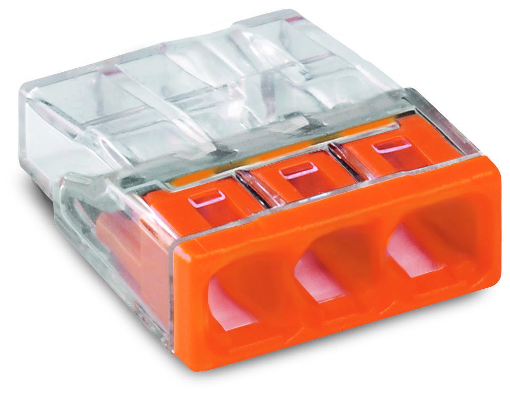

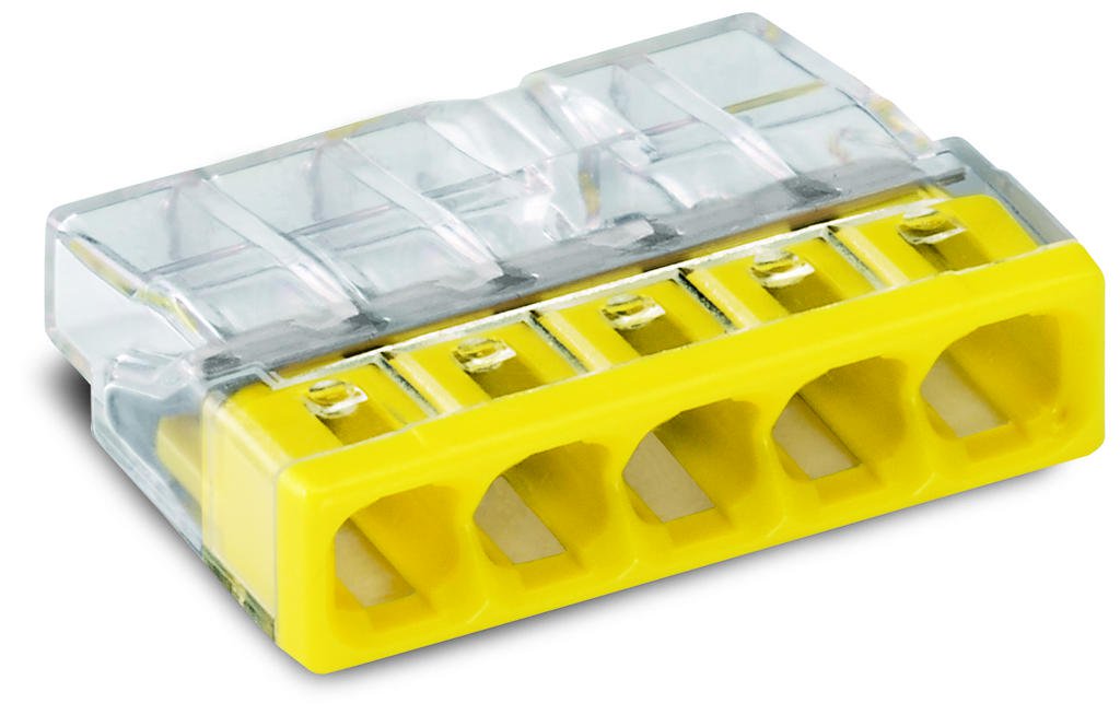

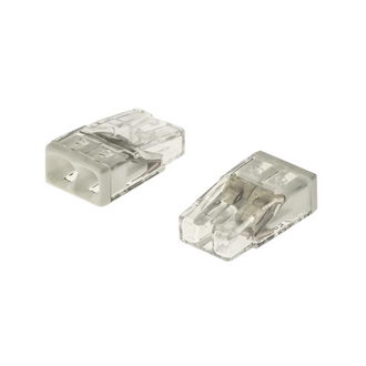

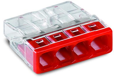

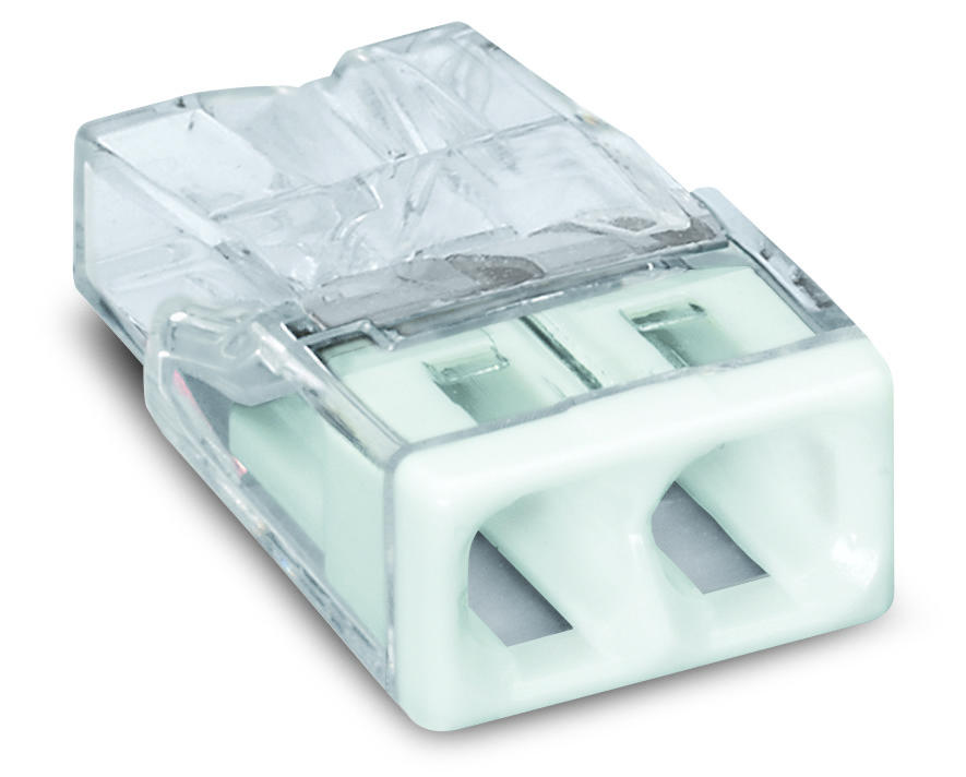

| Parameters / Models | 2273-202![]() | 2273-203![]() | 2273-204![]() | 2273-205![]() | 2273-208![]() | 2273-500![]() |
| Actuation type | Push-in | Push-in | Push-in | Push-in | Push-in | |
| Цвет | transparent | transparent | red | yellow | transparent | orange |
| Connectable conductor materials | Copper | Copper | Copper | Copper | Copper | |
| Connection technology | PUSH WIRE® | PUSH WIRE® | PUSH WIRE® | PUSH WIRE® | PUSH WIRE® | |
| Country of origin | DE | DE | DE | DE | DE | DE |
| Cover color | white | orange | red | yellow | light gray | |
| Габариты: глубина | 16.7 mm / 0.657 inch | 16.7 mm / 0.657 inch | 16.7 mm / 0.657 inch | 16.7 mm / 0.657 inch | 16.7 mm / 0.657 inch | 72.5 mm / 2.854 inch |
| Fire load, MJ | 0.014 | 0.019 | 0.025 | 0.03 | 0.039 | 0.322 |
| Flammability class per UL94 | V2 | V2 | V2 | V2 | V2 | |
| GTIN | 4050821027843 | 4050821027850 | 4050821027867 | 4050821027874 | 4050821027881 | 4050821101871 |
| Height | 5.8 mm / 0.228 inch | 5.8 mm / 0.228 inch | 5.8 mm / 0.228 inch | 5.8 mm / 0.228 inch | 10.4 mm / 0.409 inch | |
| Height from upper-edge of DIN-35 rail | 21.5 mm / 0.846 inch | |||||
| Legend (ratings) | (II / 2) ≙ Overvoltage category II / Pollution degree 2 | (II / 2) ≙ Overvoltage category II / Pollution degree 2 | (II / 2) ≙ Overvoltage category II / Pollution degree 2 | (II / 2) ≙ Overvoltage category II / Pollution degree 2 | (II / 2) ≙ Overvoltage category II / Pollution degree 2 | |
| Product Group | 7 (Push Wire Conn.) | 7 (Push Wire Conn.) | 7 (Push Wire Conn.) | 7 (Push Wire Conn.) | 7 (Push Wire Conn.) | 7 (Push Wire Conn.) |
| Rated current, A | 24 | 24 | 24 | 24 | 24 | |
| Rated impulse voltage (II / 2), kV | 4 | 4 | 4 | 4 | 4 | |
| Rated voltage (II / 2), В | 450 | 450 | 450 | 450 | 450 | |
| Solid conductor | 0.5 … 2.5 mm² / 20 … 14 AWG | 0.5 … 2.5 mm² / 20 … 14 AWG | 0.5 … 2.5 mm² / 20 … 14 AWG | 0.5 … 2.5 mm² / 20 … 14 AWG | 0.5 … 2.5 mm² / 20 … 14 AWG | |
| Strip length | 11 mm / 0.43 Inch | 11 mm / 0.43 Inch | 11 mm / 0.43 Inch | 11 mm / 0.43 Inch | 11 mm / 0.43 Inch | |
| Surrounding air (operating) temperature | 60 °C | 60 °C | 60 °C | 60 °C | 60 °C | |
| T-Marking per EN 60998 | T60 | T60 | T60 | T60 | T60 | |
| Total number of connection points | 2 | 3 | 4 | 5 | 8 | |
| Total number of potentials | 1 | 1 | 1 | 1 | 1 | |
| Type of wiring | Side-entry wiring | Side-entry wiring | Side-entry wiring | Side-entry wiring | Side-entry wiring | |
| Вес, г | 0.713 | 1.017 | 1.3 | 1.581 | 2.17 | 10.74 |
| Ширина | 10 mm / 0.394 inch | 14 mm / 0.551 inch | 18 mm / 0.709 inch | 22 mm / 0.866 inch | 18 mm / 0.709 inch | 18.5 mm / 0.728 inch |
