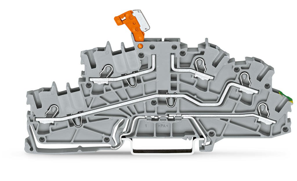

Parameters / Models | 2003-499![]() | 2003-500![]() | 2003-6640![]() | 2003-6641![]() | 2003-6642![]() | 2003-6643![]() | 2003-6644![]() | 2003-6645![]() | 2003-6646![]() | 2003-6649![]() | 2003-6650![]() | 2003-6651![]() | 2003-6660![]() | 2003-6661![]() | 2003-6692![]() | 2003-6693![]() | 2003-7300![]() | 2003-7640![]() | 2003-7641![]() | 2003-7642![]() | 2003-7645![]() | 2003-7646![]() | 2003-7649![]() | 2003-7650![]() | 2003-7651![]() | 2003-7659![]() | 2003-7692![]() | 2003-911![]() | 2003-911/1000-923![]() |
Actuation type, Operating tool | Open Tool Slot | Open Tool Slot | Open Tool Slot | Open Tool Slot | Open Tool Slot | Open Tool Slot | Open Tool Slot | Open Tool Slot | Open Tool Slot | Open Tool Slot | Open Tool Slot | Push-in | Push-in | Push-in | Push-in | Push-in | Push-in | Push-in | Push-in | Push-in | Push-in | ||||||||
Цвет | gray | gray | gray | gray | gray | gray | gray | gray | gray | gray | gray | gray | gray | gray | orange | orange | orange | gray | gray | gray | gray | gray | gray | gray | gray | gray | orange | gray | gray |
Connectable conductor materials | Copper | Copper | Copper | Copper | Copper | Copper | Copper | Copper | Copper | Copper | Copper | Copper | Copper | Copper | Copper | Copper | Copper | Copper | Copper | Copper | Copper | ||||||||
Connection technology | CAGE CLAMP® | CAGE CLAMP® | Push-in CAGE CLAMP® | Push-in CAGE CLAMP® | Push-in CAGE CLAMP® | Push-in CAGE CLAMP® | Push-in CAGE CLAMP® | Push-in CAGE CLAMP® | Push-in CAGE CLAMP® | Push-in CAGE CLAMP® | Push-in CAGE CLAMP® | Push-in CAGE CLAMP® | Push-in CAGE CLAMP® | Push-in CAGE CLAMP® | Push-in CAGE CLAMP® | Push-in CAGE CLAMP® | Push-in CAGE CLAMP® | Push-in CAGE CLAMP® | Push-in CAGE CLAMP® | Push-in CAGE CLAMP® | Push-in CAGE CLAMP® | Push-in CAGE CLAMP® | Push-in CAGE CLAMP® | ||||||
Country of origin | DE | DE | CN | CN | CN | CN | CN | CN | CN | CN | CN | CN | CN | CN | DE | DE | DE | DE | DE | DE | DE | DE | DE | DE | DE | DE | DE | DE | DE |
Габариты: глубина | 110 mm / 4.331 inch | 110 mm / 4.331 inch | 110 mm / 4.331 inch | 110 mm / 4.331 inch | 110 mm / 4.331 inch | 110 mm / 4.331 inch | 110 mm / 4.331 inch | 110 mm / 4.331 inch | 110 mm / 4.331 inch | 110 mm / 4.331 inch | 110 mm / 4.331 inch | 110 mm / 4.331 inch | 110 mm / 4.331 inch | 110 mm / 4.331 inch | 96 mm / 3.78 inch | 96 mm / 3.78 inch | 96 mm / 3.78 inch | 96 mm / 3.78 inch | 96 mm / 3.78 inch | 96 mm / 3.78 inch | 96 mm / 3.78 inch | 96 mm / 3.78 inch | 96 mm / 3.78 inch | 96 mm / 3.78 inch | |||||
Design | angled | angled | angled | angled | angled | angled | angled | angled | angled | angled | angled | angled | angled | angled | angled | angled | angled | angled | angled | angled | angled | ||||||||
Fine-stranded conductor | 0.5 … 2.5 mm² / 20 … 16 AWG | 0.5 … 2.5 mm² / 20 … 16 AWG | 0.25 … 4 mm² / 22 … 12 AWG | 0.25 … 4 mm² / 22 … 12 AWG | 0.25 … 4 mm² / 22 … 12 AWG | 0.25 … 4 mm² / 22 … 12 AWG | 0.25 … 4 mm² / 22 … 12 AWG | 0.25 … 4 mm² / 22 … 12 AWG | 0.25 … 4 mm² / 22 … 12 AWG | 0.25 … 4 mm² / 22 … 12 AWG | 0.25 … 4 mm² / 22 … 12 AWG | 0.25 … 4 mm² / 22 … 12 AWG | 0.25 … 4 mm² / 22 … 12 AWG | 0.25 … 4 mm² / 22 … 12 AWG | 0.25 … 4 mm² / 22 … 12 AWG | 0.25 … 4 mm² / 22 … 12 AWG | 0.25 … 4 mm² / 22 … 12 AWG | 0.25 … 4 mm² / 22 … 12 AWG | 0.25 … 4 mm² / 22 … 12 AWG | 0.25 … 4 mm² / 22 … 12 AWG | 0.25 … 4 mm² / 22 … 12 AWG | 0.25 … 4 mm² / 22 … 12 AWG | 0.25 … 4 mm² / 22 … 12 AWG | ||||||
Fine-stranded conductor with ferrule, push-in termination, from | 0.75 mm² / 18 AWG | 0.75 mm² / 18 AWG | 0.75 mm² / 18 AWG | 0.75 mm² / 18 AWG | 0.75 mm² / 18 AWG | 0.75 mm² / 18 AWG | 0.75 mm² / 18 AWG | 0.75 mm² / 18 AWG | 0.75 mm² / 18 AWG | 0.75 mm² / 18 AWG | 0.75 mm² / 18 AWG | 0.75 mm² / 18 AWG | 0.75 mm² / 18 AWG | 0.75 mm² / 18 AWG | 0.75 mm² / 18 AWG | 0.75 mm² / 18 AWG | 0.75 mm² / 18 AWG | 0.75 mm² / 18 AWG | 0.75 mm² / 18 AWG | 0.75 mm² / 18 AWG | 0.75 mm² / 18 AWG | ||||||||
Fire load, MJ | 0.065 | 0.064 | 0.309 | 0.316 | 0.307 | 0.309 | 0.316 | 0.308 | 0.308 | 0.307 | 0.306 | 0.306 | 0.309 | 0.309 | 0.112 | 0.124 | 0.005 | 0.252 | 0.247 | 0.24 | 0.245 | 0.245 | 0.24 | 0.242 | 0.242 | 0.245 | 0.079 | 0.171 | |
GTIN | 4050821322115 | 4050821322139 | 4050821322122 | 4050821322030 | 4050821322047 | 4050821464525 | 4050821654292 | 4050821322054 | 4050821322061 | 4050821322078 | 4050821322085 | 4050821322092 | 4055143053501 | 4055143665483 | 4050821322108 | 4050821793489 | 4045454708481 | 4045454792695 | 4044918925587 | 4044918925594 | 4044918925600 | 4044918925617 | 4044918925624 | 4045454735944 | 4045454735951 | 4045454792749 | 4044918925648 | 4050821270416 | 4050821608134 |
Height | 44.3 mm / 1.744 inch | 44.3 mm / 1.744 inch | 42.3 mm / 1.665 inch | ||||||||||||||||||||||||||
Height from upper-edge of DIN-35 rail | 44.3 mm / 1.744 inch | 54.7 mm / 2.154 inch | 44.3 mm / 1.744 inch | 44.3 mm / 1.744 inch | 54.7 mm / 2.154 inch | 44.3 mm / 1.744 inch | 44.3 mm / 1.744 inch | 44.3 mm / 1.744 inch | 44.3 mm / 1.744 inch | 44.3 mm / 1.744 inch | 44.3 mm / 1.744 inch | 44.3 mm / 1.744 inch | 42.3 mm / 1.665 inch | 42.3 mm / 1.665 inch | 42.3 mm / 1.665 inch | 42.3 mm / 1.665 inch | 42.3 mm / 1.665 inch | 42.3 mm / 1.665 inch | 42.3 mm / 1.665 inch | 42.3 mm / 1.665 inch | 42.3 mm / 1.665 inch | ||||||||
Insulating material | Polyamide 66 (PA 66) | Polyamide 66 (PA 66) | Polyamide 66 (PA 66) | Polyamide 66 (PA 66) | Polyamide 66 (PA 66) | Polyamide 66 (PA 66) | Polyamide 66 (PA 66) | Polyamide 66 (PA 66) | Polyamide 66 (PA 66) | Polyamide 66 (PA 66) | Polyamide 66 (PA 66) | Polyamide 66 (PA 66) | Polyamide 66 (PA 66) | Polyamide 66 (PA 66) | Polyamide 66 (PA 66) | Polyamide 66 (PA 66) | Polyamide 66 (PA 66) | Polyamide 66 (PA 66) | Polyamide 66 (PA 66) | Polyamide 66 (PA 66) | Polyamide 66 (PA 66) | ||||||||
Legend (ratings) | (III / 3) ≙ Overvoltage category III / Pollution degree 3 | (III / 3) ≙ Overvoltage category III / Pollution degree 3 | (III / 3) ≙ Overvoltage category III / Pollution degree 3 | (III / 3) ≙ Overvoltage category III / Pollution degree 3 | (III / 3) ≙ Overvoltage category III / Pollution degree 3 | (III / 3) ≙ Overvoltage category III / Pollution degree 3 | (III / 3) ≙ Overvoltage category III / Pollution degree 3 | (III / 3) ≙ Overvoltage category III / Pollution degree 3 | (III / 3) ≙ Overvoltage category III / Pollution degree 3 | (III / 3) ≙ Overvoltage category III / Pollution degree 3 | (III / 3) ≙ Overvoltage category III / Pollution degree 3 | (III / 3) ≙ Overvoltage category III / Pollution degree 3 | (III / 3) ≙ Overvoltage category III / Pollution degree 3 | (III / 3) ≙ Overvoltage category III / Pollution degree 3 | (III / 3) ≙ Overvoltage category III / Pollution degree 3 | (III / 3) ≙ Overvoltage category III / Pollution degree 3 | (III / 3) ≙ Overvoltage category III / Pollution degree 3 | (III / 3) ≙ Overvoltage category III / Pollution degree 3 | (III / 3) ≙ Overvoltage category III / Pollution degree 3 | (III / 3) ≙ Overvoltage category III / Pollution degree 3 | (III / 3) ≙ Overvoltage category III / Pollution degree 3 | (III / 3) ≙ Overvoltage category III / Pollution degree 3 | (III / 3) ≙ Overvoltage category III / Pollution degree 3 | ||||||
Marking level | Center/side marking | Center/side marking | Center/side marking | Center/side marking | Center/side marking | Center/side marking | Center/side marking | Center/side marking | Center/side marking | Center/side marking | Center/side marking | Center/side marking | Center/side marking | Center/side marking | Center/side marking | Center/side marking | Center/side marking | Center/side marking | Center/side marking | Center/side marking | Center/side marking | Center marking | Center marking | ||||||
Nominal cross section | 2.5 mm² | 2.5 mm² | 2.5 mm² | 2.5 mm² | 2.5 mm² | 2.5 mm² | 2.5 mm² | 2.5 mm² | 2.5 mm² | 2.5 mm² | 2.5 mm² | 2.5 mm² | 2.5 mm² | 2.5 mm² | 2.5 mm² | 2.5 mm² | 2.5 mm² | 2.5 mm² | 2.5 mm² | 2.5 mm² | 2.5 mm² | ||||||||
Number of levels | 3 | 3 | 3 | 3 | 3 | 3 | 3 | 3 | 1 | 1 | 3 | 3 | 3 | 3 | 2 | 3 | 3 | 2 | 3 | 3 | 3 | ||||||||
Plug width | 10.4 mm / 0.409 inch | 10.4 mm / 0.409 inch | |||||||||||||||||||||||||||
Potential marking | N/L/PE | NTi/L/PE | L/L | P2/P1/PE | LTi/L/PE | L/L/PE | N/L/PE | N/L | L | N | P1/P2/PE | L/N/PE | NT/L | NT/L/PE | L/L | L/L/PE | N/L/PE | N/L | L | N | LT/L | ||||||||
Product Group | 22 (TOPJOB S) | 22 (TOPJOB S) | 22 (TOPJOB S) | 22 (TOPJOB S) | 22 (TOPJOB S) | 22 (TOPJOB S) | 22 (TOPJOB S) | 22 (TOPJOB S) | 22 (TOPJOB S) | 22 (TOPJOB S) | 22 (TOPJOB S) | 22 (TOPJOB S) | 22 (TOPJOB S) | 22 (TOPJOB S) | 22 (TOPJOB S) | 22 (TOPJOB S) | 22 (TOPJOB S) | 22 (TOPJOB S) | 22 (TOPJOB S) | 22 (TOPJOB S) | 22 (TOPJOB S) | 22 (TOPJOB S) | 22 (TOPJOB S) | 22 (TOPJOB S) | 22 (TOPJOB S) | 22 (TOPJOB S) | |||
Rated current, A | 16 | 16 | 10 | 20 | 24 | 10 | 20 | 24 | 24 | 25 | 25 | 25 | 10 | 10 | 32 | 32 | 32 | 32 | 32 | 32 | 32 | 32 | 32 | 6.3 | 6.3 | ||||
Rated current (2), A | 32 | 32 | 32 | 32 | 32 | ||||||||||||||||||||||||
Rated impulse voltage (III / 3), kV | 6 | 6 | 4 | 4 | 6 | 4 | 4 | 4 | 4 | 6 | 6 | 6 | 4 | 4 | 4 | 4 | 6 | 4 | 4 | 6 | 6 | 6 | 4 | ||||||
Rated impulse voltage (III / 3) 2, kV | 6 | 6 | 6 | 6 | 6 | 6 | 6 | 6 | 6 | 6 | 6 | 6 | 6 | ||||||||||||||||
Rated voltage (III / 3), В | 500 | 500 | 250 | 250 | 400 | 250 | 250 | 250 | 250 | 400 | 400 | 400 | 250 | 250 | 250 | 250 | 400 | 250 | 250 | 400 | 400 | 400 | 250 | 250 | 250 | ||||
Rated voltage (III / 3) 2, В | 400 | 400 | 400 | 400 | 400 | 400 | 400 | 400 | 400 | 400 | 400 | 400 | 400 | ||||||||||||||||
Ratings note | potential - ground | potential - ground | potential - ground | potential - ground | potential - ground | potential - ground | potential - ground | potential - ground | potential - ground | potential - ground | potential - ground | potential - ground | potential - ground | ||||||||||||||||
Ratings note 2 | potential-potential | potential-potential | potential-potential | potential-potential | potential-potential | potential-potential | potential-potential | potential-potential | potential-potential | potential-potential | potential-potential | potential-potential | potential-potential | ||||||||||||||||
Solid conductor | 0.5 … 2.5 mm² / 20 … 16 AWG | 0.5 … 2.5 mm² / 20 … 16 AWG | 0.25 … 4 mm² / 22 … 12 AWG | 0.25 … 4 mm² / 22 … 12 AWG | 0.25 … 4 mm² / 22 … 12 AWG | 0.25 … 4 mm² / 22 … 12 AWG | 0.25 … 4 mm² / 22 … 12 AWG | 0.25 … 4 mm² / 22 … 12 AWG | 0.25 … 4 mm² / 22 … 12 AWG | 0.25 … 4 mm² / 22 … 12 AWG | 0.25 … 4 mm² / 22 … 12 AWG | 0.25 … 4 mm² / 22 … 12 AWG | 0.25 … 4 mm² / 22 … 12 AWG | 0.25 … 4 mm² / 22 … 12 AWG | 0.25 … 4 mm² / 22 … 12 AWG | 0.25 … 4 mm² / 22 … 12 AWG | 0.25 … 4 mm² / 22 … 12 AWG | 0.25 … 4 mm² / 22 … 12 AWG | 0.25 … 4 mm² / 22 … 12 AWG | 0.25 … 4 mm² / 22 … 12 AWG | 0.25 … 4 mm² / 22 … 12 AWG | 0.25 … 4 mm² / 22 … 12 AWG | 0.25 … 4 mm² / 22 … 12 AWG | ||||||
Solid conductor, push-in termination | 0.75 … 4 mm² / 18 … 12 AWG | 0.75 … 4 mm² / 18 … 12 AWG | 0.75 … 4 mm² / 18 … 12 AWG | 0.75 … 4 mm² / 18 … 12 AWG | 0.75 … 4 mm² / 18 … 12 AWG | 0.75 … 4 mm² / 18 … 12 AWG | 0.75 … 4 mm² / 18 … 12 AWG | 0.75 … 4 mm² / 18 … 12 AWG | 0.75 … 4 mm² / 18 … 12 AWG | 0.75 … 4 mm² / 18 … 12 AWG | 0.75 … 4 mm² / 18 … 12 AWG | 0.75 … 4 mm² / 18 … 12 AWG | 0.75 … 4 mm² / 18 … 12 AWG | 0.75 … 4 mm² / 18 … 12 AWG | 0.75 … 4 mm² / 18 … 12 AWG | 0.75 … 4 mm² / 18 … 12 AWG | 0.75 … 4 mm² / 18 … 12 AWG | 0.75 … 4 mm² / 18 … 12 AWG | 0.75 … 4 mm² / 18 … 12 AWG | 0.75 … 4 mm² / 18 … 12 AWG | 0.75 … 4 mm² / 18 … 12 AWG | ||||||||
Stranded conductor | 0.5 … 1.5 mm² / 20 … 16 AWG | 0.5 … 1.5 mm² / 20 … 16 AWG | |||||||||||||||||||||||||||
Strip length | 9 … 11 mm / 0.35 … 0.43 Inch | 9 … 11 mm / 0.35 … 0.43 Inch | 10 … 12 mm / 0.39 … 0.47 Inch | 10 … 12 mm / 0.39 … 0.47 Inch | 10 … 12 mm / 0.39 … 0.47 Inch | 10 … 12 mm / 0.39 … 0.47 Inch | 10 … 12 mm / 0.39 … 0.47 Inch | 10 … 12 mm / 0.39 … 0.47 Inch | 10 … 12 mm / 0.39 … 0.47 Inch | 10 … 12 mm / 0.39 … 0.47 Inch | 10 … 12 mm / 0.39 … 0.47 Inch | 10 … 12 mm / 0.39 … 0.47 Inch | 10 … 12 mm / 0.39 … 0.47 Inch | 10 … 12 mm / 0.39 … 0.47 Inch | 10 … 12 mm / 0.39 … 0.47 Inch | 10 … 12 mm / 0.39 … 0.47 Inch | 10 … 12 mm / 0.39 … 0.47 Inch | 10 … 12 mm / 0.39 … 0.47 Inch | 10 … 12 mm / 0.39 … 0.47 Inch | 10 … 12 mm / 0.39 … 0.47 Inch | 10 … 12 mm / 0.39 … 0.47 Inch | 10 … 12 mm / 0.39 … 0.47 Inch | 10 … 12 mm / 0.39 … 0.47 Inch | ||||||
Total number of connection points | 1 | 1 | 5 | 5 | 4 | 5 | 5 | 5 | 5 | 4 | 2 | 2 | 5 | 5 | 3 | 5 | 4 | 5 | 5 | 4 | 2 | 2 | 3 | ||||||
Total number of potentials | 1 | 1 | 3 | 3 | 3 | 3 | 3 | 3 | 3 | 3 | 1 | 1 | 3 | 3 | 2 | 3 | 2 | 3 | 3 | 2 | 1 | 1 | 2 | ||||||
Type of mounting | DIN-35 rail | DIN-35 rail | DIN-35 rail | DIN-35 rail | DIN-35 rail | DIN-35 rail | DIN-35 rail | DIN-35 rail | DIN-35 rail | DIN-35 rail | DIN-35 rail | DIN-35 rail | DIN-35 rail | DIN-35 rail | DIN-35 rail | DIN-35 rail | DIN-35 rail | DIN-35 rail | DIN-35 rail | DIN-35 rail | DIN-35 rail | ||||||||
Type of wiring | Side-entry wiring | Side-entry wiring | Front-entry wiring | Front-entry wiring | Front-entry wiring | Front-entry wiring | Front-entry wiring | Front-entry wiring | Front-entry wiring | Front-entry wiring | Front-entry wiring | Front-entry wiring | Front-entry wiring | Front-entry wiring | Front-entry wiring | Front-entry wiring | Front-entry wiring | Front-entry wiring | Front-entry wiring | Front-entry wiring | Front-entry wiring | Front-entry wiring | Front-entry wiring | ||||||
Вес, г | 3.328 | 3.018 | 19.942 | 20.449 | 17.232 | 19.942 | 20.449 | 20.052 | 20.052 | 17.232 | 12.686 | 12.686 | 19.942 | 19.942 | 3.36 | 4.19 | 0.16 | 14.165 | 16.7 | 13.608 | 16.318 | 16.318 | 13.608 | 9.753 | 9.753 | 13.934 | 2.45 | 12.09 | 12.79 |
Ширина | 5.2 mm / 0.205 inch | 5.2 mm / 0.205 inch | 5.2 mm / 0.205 inch | 5.2 mm / 0.205 inch | 5.2 mm / 0.205 inch | 5.2 mm / 0.205 inch | 5.2 mm / 0.205 inch | 5.2 mm / 0.205 inch | 5.2 mm / 0.205 inch | 5.2 mm / 0.205 inch | 5.2 mm / 0.205 inch | 5.2 mm / 0.205 inch | 0.8 mm / 0.031 inch | 1 mm / 0.039 inch | 5.2 mm / 0.205 inch | 5.2 mm / 0.205 inch | 5.2 mm / 0.205 inch | 5.2 mm / 0.205 inch | 5.2 mm / 0.205 inch | 5.2 mm / 0.205 inch | 5.2 mm / 0.205 inch | 5.2 mm / 0.205 inch | 5.2 mm / 0.205 inch | 0.8 mm / 0.031 inch | 10.4 mm / 0.409 inch | 10.4 mm / 0.409 inch |
